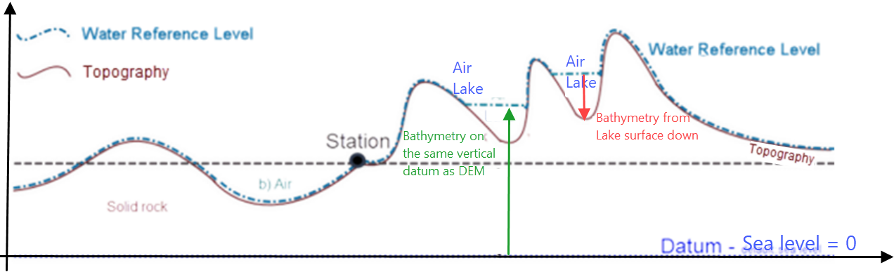

Overlap
If the vertical datum of the bathymetry grid has its zero on the surface of the water and is positive downwards (red arrow in the illustration below), choose DEM-Bathymetry for overlap.
If the DEM and bathymetry grids are provided in the same vertical datum (green arrow in the illustration below), choose Bathymetry for overlap.
If the footprint of the bathymetry grid consists mostly of dummies in the DEM grid with a small overlap along the contact of the two grids, then the bathymetry grid must be provided on the same vertical datum as the DEM grid, and the overlap can be averaged. In this case use the Average option. This option performs a simple averaging in the overlap areas. If the nature of the two input grids is very different, we recommend that you use GridKnit (see the Knit Grids Together topic).
The option DEM would be used if the intent is to make the output footprint of the DEM grid match the footprint of the bathymetry grid.
