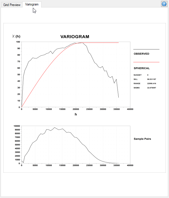

The example below illustrates a variogram of data generated based on the spherical model and the intelligent calculated defaults for the variogram model parameters:
The variogram (in fact this is the semi-variogram, but we call it variogram for brevity) shows the correlation (semivariance) of the data as a function of the distance away from the sampling point. Ideally, the red curve representing the variogram model should match the black line representing the observed data. Normally, the variogram reaches a point (sill value) at which the semi-variance (variogram) plateaus. The corresponding h value is called the range value – beyond this distance there is no similarity in samples. At the right end of the variogram, the variability may appear to decrease, but this is usually the result of too few pairs of samples for the statistics to be valid.
The sample pairs are plotted below the variogram. The plot shows how many sets of samples occur within specified distances of each other – this curve may help you to refine your variogram in the selection of the data points used to visualize your model curve. In the illustration above, most of the data occurs within ~ 12 000 m, and data beyond this point should not be given as high an emphasis when building the variogram.
