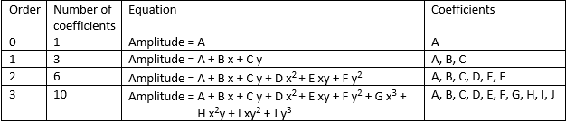

Trend order |
Order of trend to remove: 0,1,2, or 3. (Default is 1.) Script Parameter: GRIDTRND.ORDER |
Polynomial coefficients |
Coefficients of the polynomial. If left blank, the coefficients are calculated. If supplied, they take precedence and the coefficients will not be calculated. This is a comma-delimited string of up to ten real numbers (see Application Notes below). Script Parameter: GRIDTRND.COEFF |

If any coefficients are specified, there must be a correct number of coefficients depending on the Trend order specified. On the other hand, if the Trend order parameter is blank, it will default to the number supporting the supplied number of coefficients.
The GRIDTRND GX removes up to a third order trend surface from a grid. The trend surface may be user defined or calculated by least squares fitting to all the values in the grid or to only the values along the edge of the grid. GRIDTRND may also be used to replace a previously removed first or zero order trend.
