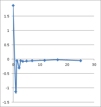

VDCF Radial Graph:
These coefficients are interpolated and normalized on a 51x51 convolution window and applied to the input grid.
