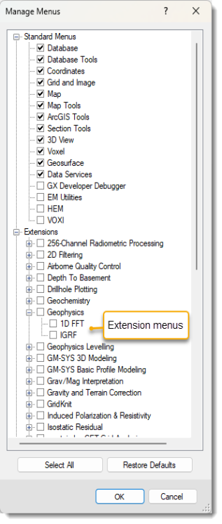

Use the Project > Manage Menus menu option or click the Manage Menus button on the Project Explorer toolbar to load or unload menus from the main menu bar in your Oasis montaj project.
Manage Menus dialog
Standard Menus
The Standard Menus node lists the default menus in your application. By default, all checked menus are loaded in new projects.

Expanding an extension node reveals its associated menus.
Each extension has a checkbox indicating the state of its menus, whether expanded or collapsed. It indicates one of the following states:
    Unchecked – No menus selected.
    Checked – All menus selected.
    Partially Checked – Some menus selected.
The extension checkbox functions as a toggle, propagating selection changes across its menus.
