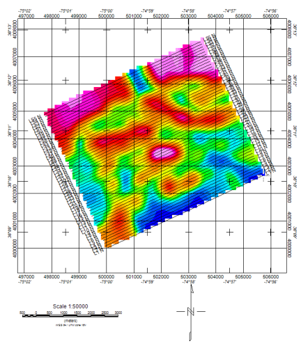

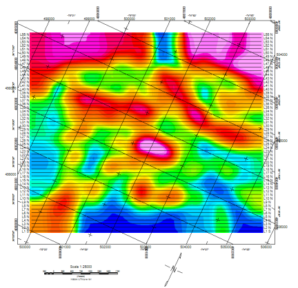

If the projection of the scanned data is rotated, you will be prompted to plot the map in either the local coordinate system (Fig. 1 - unrotated) or in the rotated (Fig. 2) orientation.
Fig. 1 - Unrotated map. North is along the Y axis.
Fig. 2 - The projection rotation is taken into account. North arrow aligns with the rotation.
