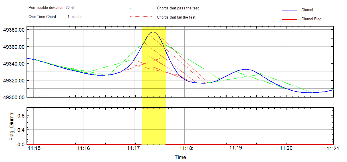

Quality Control Specification and Indicators
For each consecutive time chord, the GX looks at the difference between the diurnal mag and the straight line joining the end points of one time chord. If none of the differences along the segment exceed the permissible deviation, it is flagged as "acceptable" (flag=0); otherwise, it is flagged as "unacceptable" (flag=1). The GX then moves by one point and applies the same logic.
The flag and the maximum difference are saved at the mid-point of the moving chord window.
The maximum difference may occur at any point along the window; however, it is saved in the row representing the mid-point of the window.
As a guideline, you could set the length of chord (specified in minutes) to the average length of time required to fly between adjacent tie lines. The specified time is converted to the average number of data points in the time chord. This average is calculated independently for each line of data.
The GX creates two channels that will be automatically displayed in the active database:
- Flag_Diurnal: this channel contains a value of 0 or 1: 0 indicates points within the specification (i.e., diurnal variation is acceptable), and 1 represents points which fail the test (i.e., exceed the limit within the specified time period).
- Diurnal_Dev: this channel contains the maximum diurnal deviation of the segment. This can be compared directly against the Flag_Diurnal channel, as all values greater than the input maximum will have a flag value set to 1.0.
