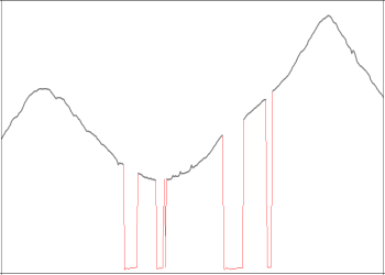

Figure 1.1: Original signal

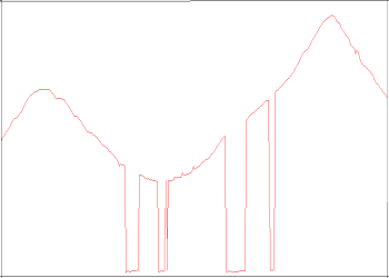

Figure 1.2: In the simplest case, the discontinuous data segments can be dummied out.

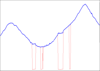

Figure 1.3: The discontinuous segments can be dummied out and splined through.

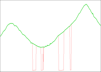

Figure 1.4: The discontinuous segments can be DC shifted to the level of the main signal.

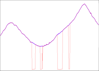

Figure 1.5: A first order trend can be applied to shift each discontinuous segment.
