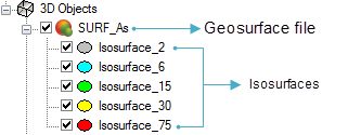

After the geosurface has been added to the 3D Viewer, the 3D Objects tree list will show the geosurface file name as the top level and below that, the surfaces within the geosurface.
Example 1: Geosurface created as output from wireframing:
Example 2: Geosurface containing isosurfaces:
