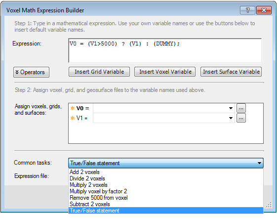

To isolate voxel cells on the lower side of an open surface and within a 50 m band:
From the Voxel menu, select Voxel Math.
The Voxel Math Expression Builder dialog appears. - Using the Common tasks drop-down list, select the True/false statement entry.
The statement, V0 = (V1>5000) ? (V1) : (DUMMY); will be added to the Expression box, as shown below:
