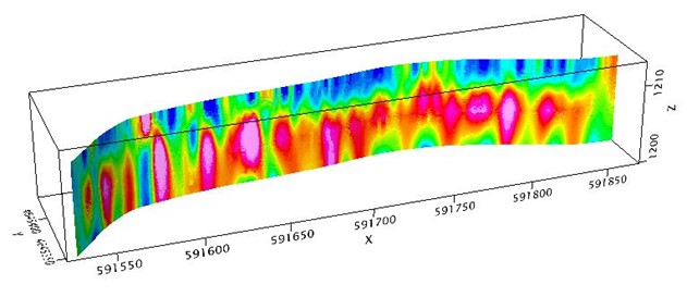

Vertically gridded profile data is frequently collected, extracted, or calculated along a line that has a non-straight path; such data is displayed in Oasis montaj using a specially defined grid orientation called "crooked section".
The following is an example of a crooked section grid displayed with a vertical exaggeration in a 3D View:

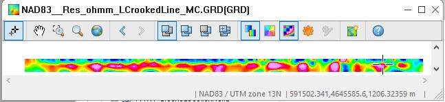

Rendering a Crooked Section Grid in the Grid View
The simplest view of a crooked section grid is in a grid window, where the grid is viewed “stretched out” with the “distance along the path” as the x-axis value and the elevation as the y-axis. The status bar still displays the correct location on the earth, because the cursor location is reprojected from the crooked section x-axis “distance” to the corresponding (X, Y) position for that distance.

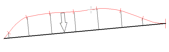

Rendering a Crooked Section Grid into a Section View
To render a crooked section grid onto a section view, we project all the crooked section grid data perpendicularly onto the section. For instance, the section might be defined as the flat plane which intersects the crooked section at its beginning and at its end:
The effect of this projection is to compress the crooked section grid; moreover, the compression is not uniform – the parts of the section, which are angled the most with reference to the view, are compressed the most, while those parts closest to being parallel to the view are almost not at all compressed.
Mathematically, the crooked section (x, y) locations are rotated into the normal section's own coordinate system, where x is along the section, y is the elevation, and z is perpendicular to the section.
For each location Xs in the normal section, the two bracketing path locations are located: one with Xc lower than or equal to Xs, and one with Xc+1 higher than Xs. Using linear interpolation, the corresponding Dc and Dc+1 are used to determine the D corresponding to the required input location, and given the crooked section origin and grid DX value, the correct column (or columns) of data is determined to project to the required location in the normal section.

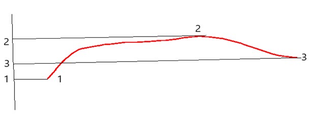

Backtracks
Not all crooked section grids can be rendered in 3D using the above method. In addition, you cannot project a crooked section onto all possible flat sections. The reason is the "backtracking" in the projected section (the crooked section grids "double-back onto themselves"). Consider projecting the above “E-W” path onto an approximately “N-S” section:
Note that from locations 2 to 3, the projection reverses and overwrites existing values on the projection plane. Any projection needs to be 1-1, so in practice if this situation is encountered, the separation into a projected and relief grid is impossible. You will have the option to plot the grid as a “pixel plot”, where each grid cell is rendered as a single square in 3D. (This eliminates any smoothing effects.)
