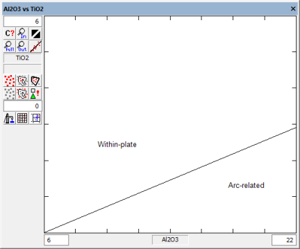

Al2O3 vs TiO2 - Distinguishes between Within-plate and Arc-related sources

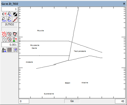

Ga vs Zr_TiO2 - For volcanic discrimination; classifies samples according to major volcanic rock types

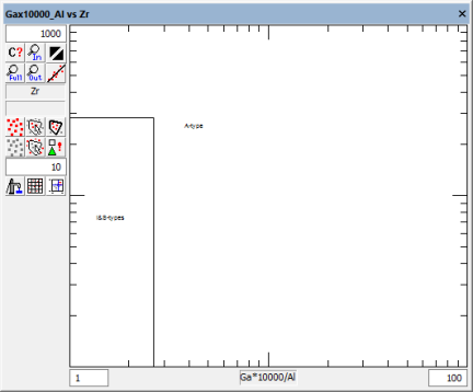

Gax10000_Al vs Zr - For granitic discrimination; distinguishes between A-type granites (within plate), and I&S-type (syn-collisional and volcanic arc) granites

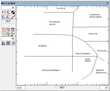

Nb_Y vs SiO2 - For volcanic discrimination; classifies samples according to major volcanic rock types using Nb/Y (as an alkalinity indicator) vs SiO2. (After Winchester and Floyd, 1977)

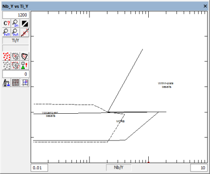

Nb_Y vs Ti_Y - For basalt discrimination; distinguishes between within-plate basalts, MORB and volcanic-arc basalts (dashed line). (After Pearce, 1982)

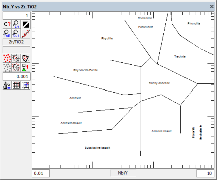

Nb_Y vs Zr_TiO2 - For alkaline /sub-alkaline basalt discrimination. (After Winchester and Floyd, 1977)

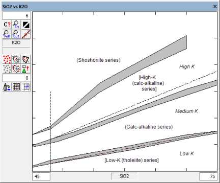

SiO2 vs K2O - For the subdivision of subalkalic rocks. Broken lines and italic labels are after Le Maitre et al., 1989; Labels in parenthesis are after Rickwood, 1989; the shaded bands denote the regions where various boundary lines fall, as summarized by Rickwood, 1989 (lines from Peccerillo and Taylor, 1976; Ewart, 1982; Innocenti et al., 1982; Carr, 1985; and Middlemost, 1985).

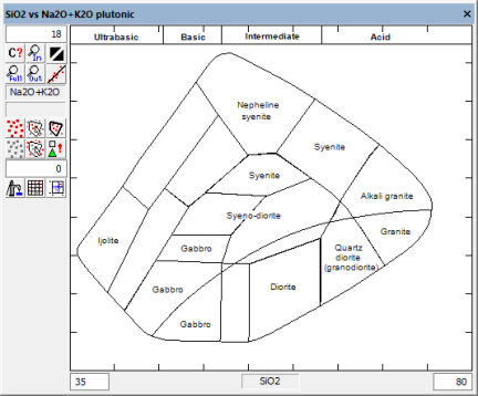

SiO2 vs Na2O+K2O plutonic - For the classification of plutonic rocks using total alkalis vs silica (TAS diagram). (After Cox et al., 1979; Wilson, 1989)

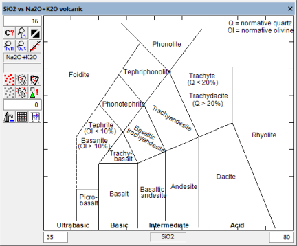

SiO2 vs Na2O+K2O volcanic - For the classification of volcanic rocks using total alkalis vs silica (TAS diagram). (After Le Maitre, 1989)

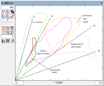

Ti_1000 vs V - For discriminating basalts; groupings are: arc tholeiite, MORB and back-arc basin, and alkali basalts. (After Shervais, 1982)

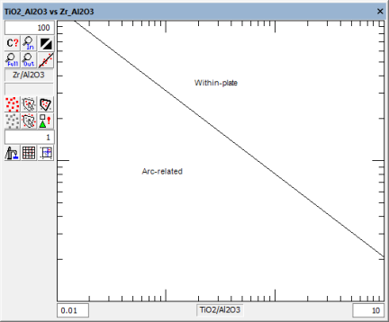

TiO2_Al2O3 vs Zr_Al2O3 - Distinguishes between Within-plate and Arc-related sources

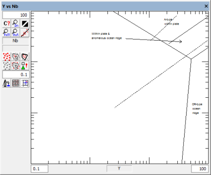

Y vs Nb - Discrimination diagram for granites, showing fields for volcanic-arc granites, within-plate granites, and ocean-ridge granites. (After Pearce et al., 1984)

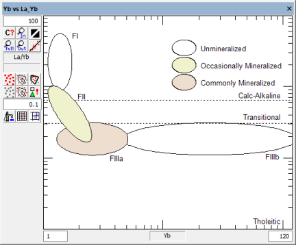

Yb vs La_Yb - For differentiation of basalts into calc-alkaline, transitional and tholeiitic

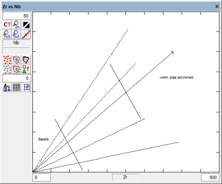

Zr vs Nb - For basalt discrimination; shows increasing within-plate enrichment.

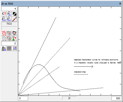

Zr vs TiO2 - Idealized fractionation curves for immobile elements in a tholeiitic volcanic suite. (After MacLean and Barrett, 1993)

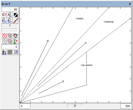

Zr vs Y - For differentiation of basalts into calc-alkaline, transitional and tholeiitic.

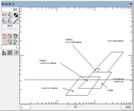

Zr vs Zr_Y - Discrimination for basalts based on Zr/Y-Zr variations.

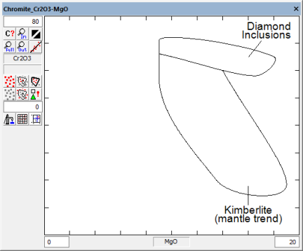

Chromite_Cr2O3-MgO - For Chromite classification; this diagram identifies and separates mantle trend kimberlites from those with compositions more likely to contain diamond inclusions. (After Gurney et al., 1993; Fipke et al., 1995)

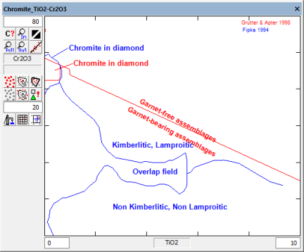

Chromite_TiO2-Cr2O3 - For Chromite classification; this diagram distinguishes between garnet-bearing and garnet free assemblages, and contains fields to separate Kimberlitic, Lamroitic and Non-Kimberlitic and Non-Lamproitic rock types. (After Fipke, 1994; Grutter & Apter, 1998)

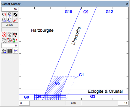

Garnet_Gurney - For Garnet classification; this diagram classifies mantle-derived garnets on the basis of Cr2O3 and CaO content. Garnets are grouped by G-number, where G10 garnets (Harzburgitic) are within the diamond facies. (After Gurney, 1984)

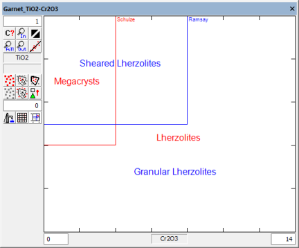

Garnet_TiO2-Cr2O3 - For Garnet classification; this diagram identifies the boundary between perioditic and megacrystic garnets. (After Schulze, 2003)

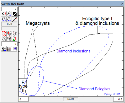

Garnet_TiO2-Na2O - For Garnet classification; this diagram identifies eclogitic and megacrystic type garnets. (After Fipke et al., 1995)

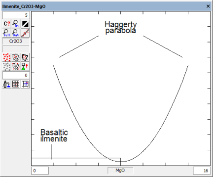

Ilmenite_Cr2O3-MgO - For Ilmenite classification; this diagram identifies basaltic ilmenites

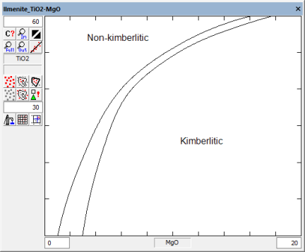

Ilmenite_TiO2-MgO - For Ilmenite classification; this diagram separates kimberlitic ilmenites from non-kimberlitic ilmenites. (After Wyatt et al., 2004)

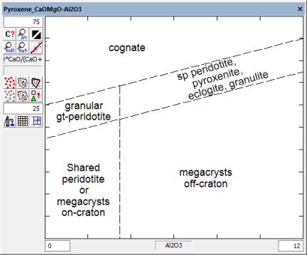

Pyroxene_CaOMgO-Al2O3 - For Pyroxene classification; this diagram separates pyroxenes into various categories: garnet bearing peridotite, spinel peridotite, megacrysts (on- and off-craton).

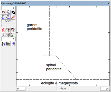

Pyroxene_Cr2O3-Al2O3 - For Pyroxene classification; this diagram distinguishes between garnet peridotite, spinel peridotite, eclogite and megacrysts.

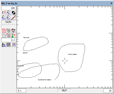

Nb_Y vs Ga_Sc - For volcanic classification

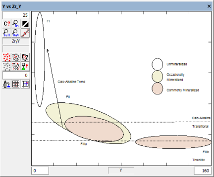

Y vs Zr_Y - For differentiation of basalts into calc-alkaline, transitional and tholeiitic groups
