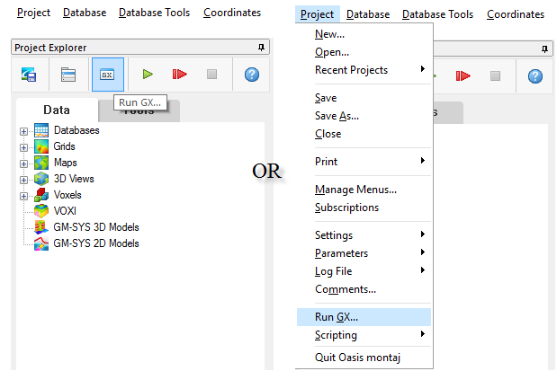

There are several ways to run a GX:
- Click on a menu or sub-menu item on the main menu bar.
 - Click the GX button on the Project Explorer toolbar, or in the Project menu, click Run GX:
