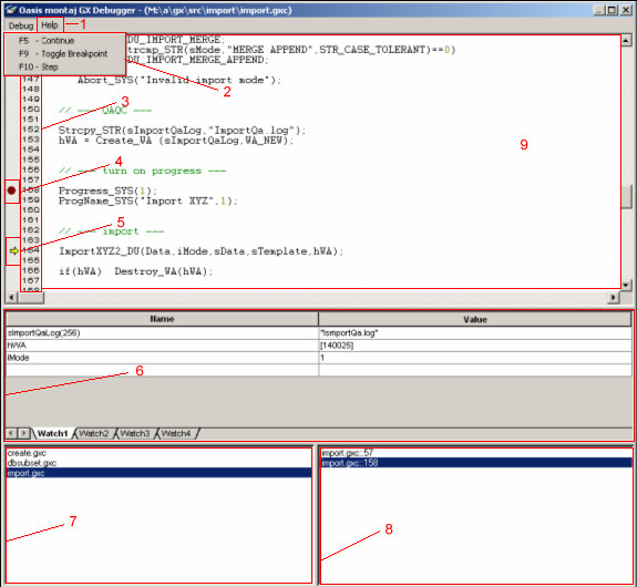

By enabling the debugger on a GX, you can step at run-time through the GXC code of the GX. You can place breakpoints in the code and search for strings. Furthermore, this process gives you access to the memory stack as well as the ability to modify the stack at run-time. The GX Debugger interface displays a typical GX debugger session. If you are familiar with Microsoft’s Visual Studio or a similar development environment, you will easily adapt to using this debugger.
The image below shows an open GX Debugger window:

2 - In this popup menu, you can choose to continue, step, or toggle a breakpoint at the cursor. However, the shortcuts shown (F5, F9 and F10) are usually the preferred way of executing these actions.

3 - This is where line numbers, breakpoints, and the current line of execution are shown.

4 - You can set/unset breakpoints at the current cursor position by hitting F9. The debugger allows you to set breakpoints on any line in any of the files preloaded into the file list. Many lines do not actually contain any execution code, and the debugger will skip over breakpoints in these lines even if you set a breakpoint on them. Problems also arise on multi-line statements where the breakpoint will only be caught if set on the last line of the GX.

5 - If no such symbol exists in the file you are currently viewing, the current position of the GX execution is elsewhere in one of the other files in the File List when you hit F9.

6 - The watch window contains four tabs where you can add watches to variables in the debugged GXs. Add a watch by typing the variable’s name in the Name column. If a variable is not in the current scope, it won’t be displayed. The size of strings and arrays is indicated in parentheses following the variable name. The second column, Value, contains the values of the watch variables. In the case of string, int, and real variables, you will be able to edit the values before stepping to the next line of execution or continuing the GX run. Object handles are treated differently. The numeric value of the object's handle is shown in square braces. When a handler for an object exists (at the moment only IPJ, PLY, and META are supported), a double-click on the handle value will pop up an editor or viewer for the object. In some cases, only a simple string representation will be presented in a read-only text box (currently the case for IPJ and PLY), and in other cases, a full-fledged editor will be started (META is a good example).

8 - This list shows you all breakpoints active in your session. Double clicking on these will take you to the location in the source code.

9 - This window displays colorized source code of one of the files in your File List.
