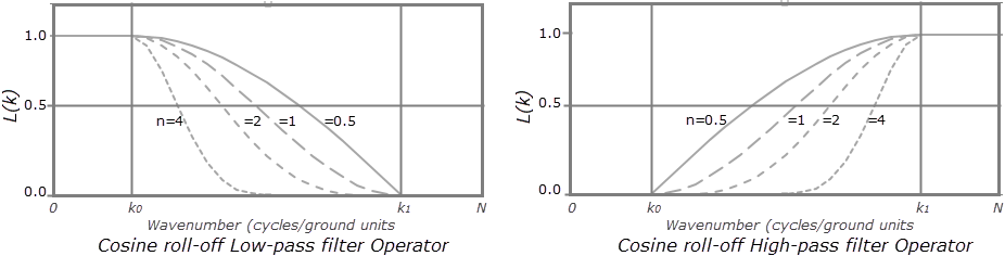

The cosine roll-off filter (see illustration) spreads the cut-off over a range in a smooth gradual fashion using a cosine function. This range is bound by two user specified wavelengths.

The higher the degree of the cosine function (see illustration), the sharper the drop-off (Default is 2).

For ease of use and interpretation, the user is prompted to enter the cutoffs in units of wavelength, starting with the small wavelength. These are internally translated to wavenumbers for processing. In the illustration below the filter is portrayed in the Fourier domain, and as a result the horizontal axis is in units of Wavenumber. Wavenumbers are the inverse of wavelengths.
Parameters:
k0 Low wavenumber, starting point of the cosine taper: k0 = Long wavelength-1
k1 High wavenumber, end point of the cosine taper. K1= Short wavelength-1
n Degree of the cosine function. The default is a degree of 2 for a cosine squared roll-off.
N Nyquist wavenumber
