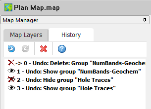

    History Tab
    This tab is used to keep track of your map editing and provides unlimited undo/redo functionality.
