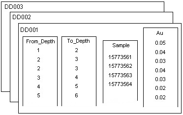

Conventional databases organize data as tables, records and fields, as shown below:
This is effective for querying and searching type applications but limits it as a data processing engine for the following reasons:
Programs must read an entire record to access a single field.
It is computationally intensive to change record structures.
Data sampled at different intervals and starting points are difficult to store.
Oasis montaj is based on a proprietary 3-dimensional-file format architecture that overcomes these limitations, as shown below:
Organized in lines (or groups), channels and elements, the database stores all data values of a particular type in individual channels. This enables stand-alone processing of columns and eliminates the need to write results to interim storage areas and then rewrite them after processing. The result is a significant increase in processing efficiency. This file structure provides additional advantages including:

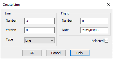

A database line is a collection of channels that are related to a single survey line. Each line has a line type, line number, version number, flight number (only required for airborne data), survey date, and selection status.
If the data comes from a ground exploration survey, you can base fiducial numbering on the survey station numbers. If the data comes from an airborne survey, the fiducial numbers are obtained directly from the airborne data acquisition system.
It is important to understand that the sample increment (fiducial increment) of each channel on a line may be different, but data between channels is related based on the fiducial number. For example, a magnetic survey might have four lines numbered 100, 200, 300 and 400. Each line might have channels of "X", "Y" and "Mag", which represents the surveyed locations and magnetic readings. Each channel on each line will have a certain number of data values, which depends on the length of the line and the sampling increment.

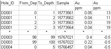

A "group" is a special kind of line. It also stores data in channels, but instead of using a name based on line number, version number, line type and flight number, it can be named using any alpha-numeric string (with some exceptions).
Each database "group" line has an optional "CLASS" name. Like a regular line, it has a selection status.
While all the channels in a database are accessible inside a regular line, a group line can restrict the available, displayable channels to a smaller subset, excluding those not relevant to the group’s data.
