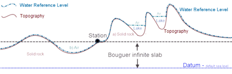

    Water reference datum
    When bodies of water are present within the survey area, you can define the water level using either a constant value or a grid.
    • Select the Constant option if the survey area includes a single body of water or if all bodies of water share the same elevation.
    • Select the Grid option for areas with high topographic relief and lakes at varying elevations. The grid will define the contact between water (or solid material) and air.
    Refer to the Application Notes for a visual illustration.
    Script Parameter: GRTERAIN.WATEROPT

    Note 1
    Figure 1: Schematic illustration of Bouguer slab, terrain, and variable water elevations

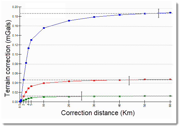

    Correction Distance Guideline
    The graph below illustrates the gradual change in the magnitude of the terrain correction as a function of the correction distance for a gravity survey conducted in rugged topography (in red). The topography was scaled to create the other two profiles. The graphs asymptotically approach a limit (thin grey lines) at a distance from the gravity station. Selecting a correction distance at 95% of the asymptote is reasonable. Asymptotes are shown with thin grey lines, the 95% threshold is marked with a dashed line, and the intersection points are indicated by grey bars.
    Figure 2: Profiles of terrain correction versus correction distance for three DEM grids of varying reliefs.
    The DEM grid used to produce the terrain effect of the red profile has a maximum vertical topographic range of 300 m, with a standard deviation of 67 m. The graph asymptotes near 0.049 mGal, and 95% of this amplitude is reached at a distance of 44 km—an adequate distance for this DEM.
    The DEM grid for the blue profile shows a maximum vertical topographic range of 660 m and a standard deviation of 135 m (approximately double the grid above). The graph asymptotes around 0.196 mGal, reaching 95% of this value at 55 km—again, an adequate distance.
    The DEM grid for the green profile has a maximum vertical topographic range of 165 m and a standard deviation of 32.5 m (half of the first DEM grid). The corresponding graph asymptotes at approximately 0.012 mGal, with 95% of the amplitude reached at 25 km—an adequate distance for this DEM.
    Conclusion: There is no one-to-one relationship between a DEM’s vertical relief and the correction distance. You should set the distance to the maximum distance of the available DEM. For very rugged areas, it is generally unnecessary to go beyond 100 km. In relatively flat terrain, much shorter distances yield reasonable results.
    In general:
    • For relatively flat regions where the variability of the terrain is in the tens of meters, terrain corrections typically range from 0.1 to 1 mGal.
    • In hilly regions with variability in the hundreds of meters, terrain effects are on the order of 1 to 10 mGal.
    • In mountainous areas, the terrain effect may reach several tens of mGal.
    • Avoid measuring gravity at the edge of sharp relief—such as cliffs or gorges—as terrain correction at these locations will inevitably be less accurate.

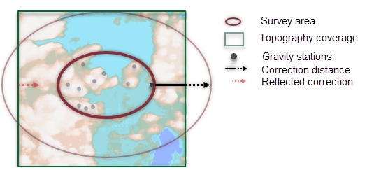

    Topography Grid
    The topography grid must cover the entire gravity survey area and extend at least the correction distance beyond the edges of the survey perimeter. Dummy terrain values are interpolated using a weighted average of the surrounding points.
    If the grid does not extend sufficiently beyond the survey area, and the specified correction distance exceeds the gap between the topography grid outline and the survey perimeter, the grid will be extended to meet the required margin. This extension is simply the other edge of the topography grid reflected on the opposite side. However, this is a fallback method and may introduce errors in terrain effect calculations if the nature of the topography changes significantly or if the survey terrain has a regional slope. The correction distance should therefore be selected carefully to avoid introducing errors at stations near the edge of the defined topography grid.
    ../../geohelp/image/grterrain.png

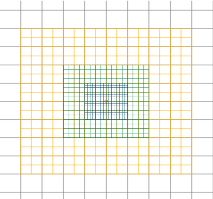

    To calculate the correction at each gravity station, the topography grid is resampled and centred on the station (see Figure 3), then extended to the specified correction distance (see Figure 4).
    Figure 4: The DEM grid ( grey grid) is resampled (blue grid) and centred on each gravity station (red symbol).
    The correction is calculated using a series of concentric square zones. The total terrain correction is the sum of the effects from each zone:
    • Near zone (Zone 0): Consists of one cell centred on the station, subdivided into four sloped prisms.
    • Intermediate zones:
      • Zone 1: Extends from cells 2 to 8 moving away from the station; treated as flat-topped square prisms.
      • Zone 2: Extends from cells 9 to 16 beyond the station.
    • Far zones (Zone 3 and beyond): Comprised of concentric flat-topped square rings beyond 16 cells. The number of far zones depends on the defined correction distance.
    Each zone is spatially aligned with the next to ensure continuous spatial coverage. To reduce computation time, the zones are progressively desampled by a factor of 2, with each cell representing the average of the grid values it covers— see Figure 5a:
    • Zone 1: DEM cells are at the input DEM grid increment.
    • Zone 2: Every four adjacent DEM cells are averaged into one cell.
    • Zone 3: Every 16 adjacent DEM cells are averaged into one cell.
    • And so on.
    When the Optimize process option is enabled, the desampling factor increases from 2 to 4, further enhancing performance— see Figure 5b:
    • Zone 2: Every 16 adjacent DEM cells are averaged into one cell.
    • Zone 3: Every 64 adjacent DEM cells are averaged into one cell.
    • And so on.
    Each zone covers the same area but uses coarser resolution as its distance from the station increases. This hierarchical approach ensures that high-resolution detail is preserved where it matters most—near the station—while using lower-resolution data in more distant areas to reduce computational load without significantly impacting accuracy.
    Figure 5a: Resampling of DEM by a factor of 2 for each gravity station by zones
    Figure 5b: Resampling of DEM by a factor of 4 for each gravity station by zones

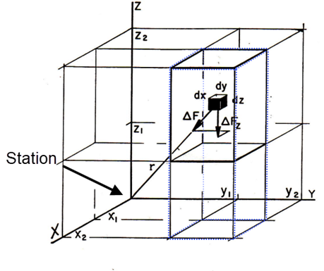

    Zones 1 & 2: Right rectangular prism (Nagy)
    1 to 8 cells away from station:
    The three bars indicate the limiting values x1, x2 – y1, y2 - z1, z2. The above notation expands to nine terms, around the central cell each with a combination of xi, yj, zk.

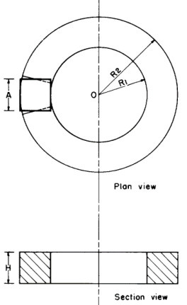

    Zone ≥3: Square segment ring (Kane)
    Beyond 8 cells away from station up the specified inner distance:
