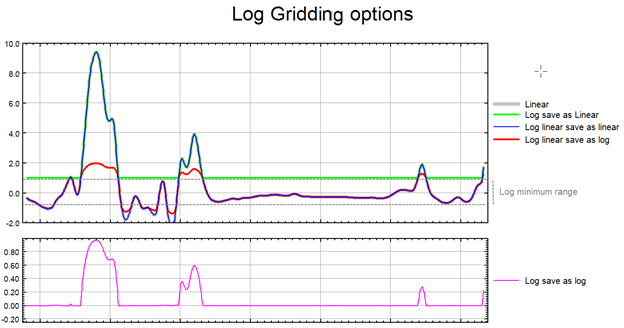

    Log Options
    If the data range is very wide and spans over several orders of magnitude, gridding in normal space may not honour the data distribution of interest, and the real patterns present in the data may get obscured in the process of gridding. If, however, the data is gridded in logarithmic space these very patterns will be revealed. Often it is more appropriate to grid geochemical data in logarithmic scale, as the element distribution changes in concentration by orders of magnitude over a short distance. Furthermore, depending on the data concentration and scatter, in order to maintain a consistent texture, it may be more appropriate to display the extremes of the data distribution in logarithmic space while the median range remains in linear space. This would be an appropriate approach with bimodal data.
    The log-linear options are not appropriate for geochemical data; they are intended for levelled geophysical data (e.g., sometimes the span of magnetic data is quite broad and in order to be able to observe the definition around the mean of the data distribution as well as at the extremes, this option is used). Prior to gridding the data for the two log-linear options, the data is altered as follows:
    if ( Z > Log_minimum))  Z = (log10( Z / Log_minimum) + 1.0) * Log_minimum);
    if ( 0 < Z ≤ Log_minimum))  Z is untouched
    if ( -Log_minimum ≤ Z ≤ 0))  Z = -Z
    if ( Z < -Log_minimum))  Z = -(log10( -Z / Log_minimum) + 1.0) * Log_minimum);
    This has the effect of treating large positive or negative values like logarithms, but gives a linear transform for values around zero.
    Log minimum value: when gridding in log space, this setting specifies the minimum cut-off in linear space. If one of the log, save as options has been selected, all values below this cut-off are replaced by Log_minimum. If one of the log-linear,save as options has been selected, this entry represents the two boundaries where the switch between linear and logarithmic gridding occurs.
    The illustration above intends to convey the variation between the various log options.
