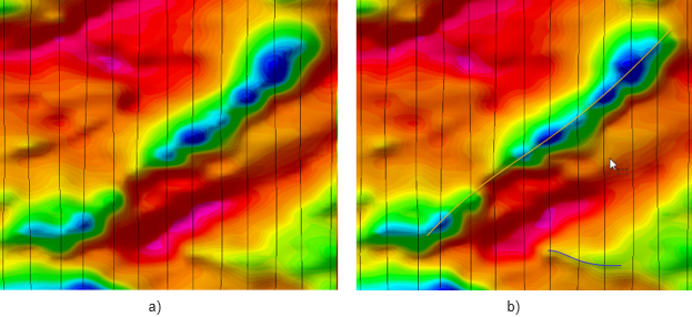

    Spline down line
    Geological trends in the data can be emphasized by the appropriate orientation of the grid so that the second interpolation is in the direction of strike. In addition to trend enhancement, BIGRID allows the method of interpolation to be selected independently for the down-line and across-line directions.
    Select from one of the interpolation methods available: linear, cubic spline (minimum curvature), Akima spline (default), or "Nearest neighbour".
    For data that is sampled at a high density relative to the grid cell size, such as is often the case for airborne data, linear interpolation is usually sufficient for the down-line spline and will produce some saving in computation time.
    Script Parameter: BIGRID.ISP1

    Trend angle
    Specify the trend angle, measured counter-clockwise from the positive X-axis (degrees CCW from +X). This parameter is used to enhance geological features in the specified direction.
    If no trend angle is specified, a default value of 0° or 90° is applied, whichever is closer to being perpendicular to the survey line direction. See the Application Notes for additional details.
    Script Parameters: BIGRID.TRA

    Gradient Enhanced Gridding
    Gridding without the cross-line gradient will interpolate the smoothest surface that honors the data along each line. Gridding with the cross-line gradient will produce a surface that both honors the data and the measured gradient at each line. This can produce much-improved gridded surfaces, especially for features that approach the line separation in size.
    Gridded magnetic data: a) without cross-line gradient; b) with cross-line gradient enhancement.
    The gradient-enhanced method implemented in BIGRID is the pseudo-line gridding method developed by Hardwick 1.
    Although gridding with gradients will work with any type of data, the principle application is in the preparation of grids from aeromagnetic surveys that use two wing-tip sensors to measure the transverse gradient. The technique used in BIGRID uses both the measured total field data and the gradients to model the magnetic field over the grid area. This requires that both the total field and the gradient data be well leveled using conventional leveling techniques. This method also ensures accurate resolution of low-amplitude, long-wavelength features in the data, which are poorly resolved in the gradient measurements alone.
