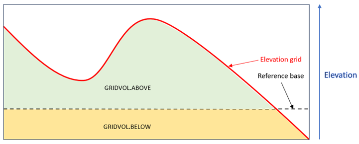

The grid volume is calculated by summing the product of the grid area times the distance between each non-dummy grid point and the supplied reference base. If the grid contains elevations lower than the reference base, volumes will be reported for both the areas above and below that base, as illustrated in the diagram and explained below.
GRIDVOL.ABOVE,GRIDVOL.BELOW, andGRIDVOL.DIFFare output-only values. -
Both
GRIDVOL.ABOVEandGRIDVOL.BELOWare reported as positive values. -
