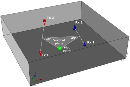

For each set of Transmitter-Receiver pairs, the symbol is placed at the 45° downwards intersection of the plane normal to the local topography. This plane passes through the midpoint of the line joining the transmitters and the line joining the receivers as illustrated below. While the horizontal scale is real, the vertical scale is not a real depth scale. This approach is analogous to the 2D pseudo-section display, where the vertical coordinate is used to visualize distinct readings with coincident horizontal locations.
The Wenner and Schlumberger array configurations do not lend themselves to a 3D array display because the midpoints of the transmitters and receivers are near coincident.
The symbols hang below the topography if one has been provided, however, the vertical location of the symbols should not be equated with real depths, and should not be directly compared with the vertical coordinate of any true 3D content such as geological features or resistivity voxels.
If the configuration does not contain a Transmitter 2 then the plane normal to the local topography passes through Transmitter 1.
If the configuration does not contain a Receiver 2 then the plane normal to the local topography passes through Receiver 1.

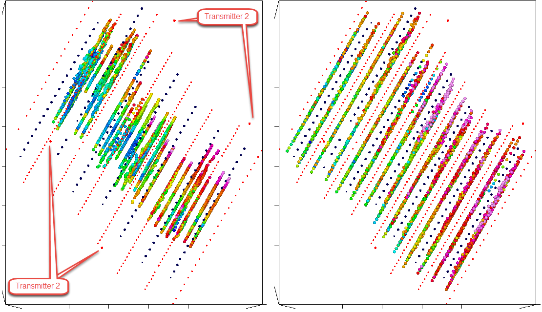

Plot Point Configuration
In essence, all IP surveys involve 4 electrodes; however, if the second transmitter and/or receiver is placed far enough from the survey area, it may be considered as located at infinity.
If the second transmitter is far away, the configuration is known as Pole-Dipole, and the coordinates of the second transmitter are generally omitted.
In the illustration below, the same IP data is shown in both Dipole-Dipole (left) and Pole-Dipole (right) configurations. The transmitter 2 electrodes are indicated on the left. On the illustration on the right, transmitter 2 is not taken into account, and as a result the 3D array plot is better aligned and easier to interpret.
On the left the Dipole-Dipole configuration is selected. On the right the Pole-Dipole configuration is selected.

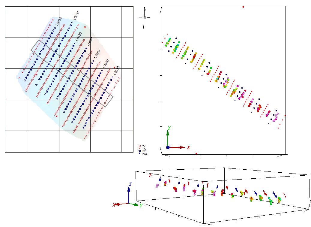

Defining the Swath
To view a narrow swath of the data that crosses multiple IP lines or to view a subset of data of a given line, you can define the swath on a plan map.
The swath is selected on the plan map (left). The resulting 3D Array plot of the swath is displayed on the right in 2 views.
