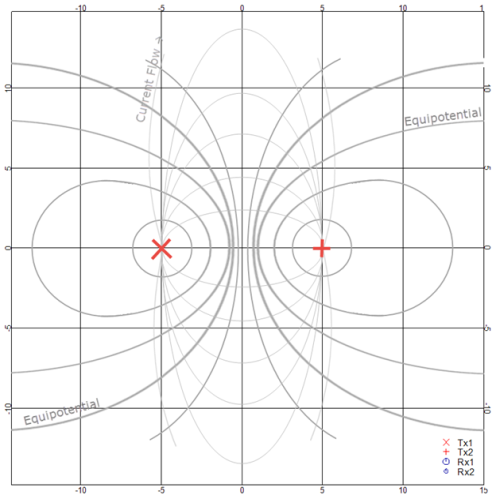

Given a good current flow between two transmitters placed on a homogeneous subsurface, the equipotentials will be distributed as indicated by the heavy grey lines in Figure 1. If two receiver electrodes are located on or near the same equipotential, there will be a negligible potential difference between them. Such a geometry is said to be "Null Coupled".
Given a good current flow in a homogeneous subsurface (thin grey lines) between two transmitters, the equipotentials are distributed as indicated by the heavy grey lines.
