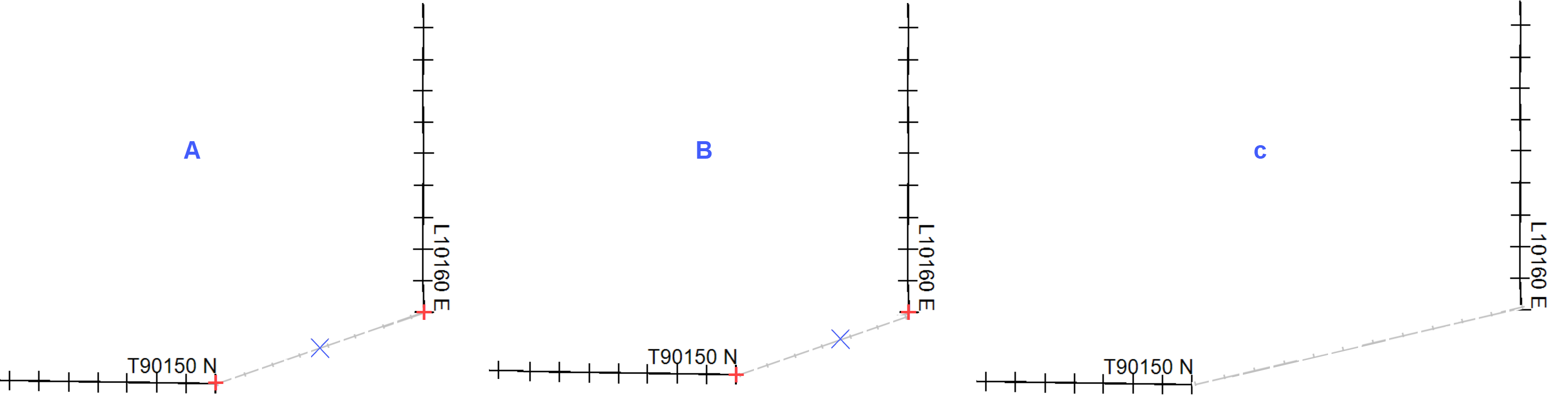

    Figure 1: The intersections table is being generated.
    A) The closest readings on each of the survey and tie lines are 7.5 nominal sample spacings apart (grey dashed line). If the Intersection tolerance field is left blank or entered to be between 7.5 and 10 sample spacings, the point marked with the blue cross will be added to the intersections table along with the details of the points marked with red +s. On the other hand, if the provided intersection tolerance is less than 7.5 sample spacings, the point marked with the blue cross will not be added to the intersection table.
    B) The closest points on each of the survey and tie lines are six nominal sample spacings apart (grey dashed line). Only the Intersection tolerance values greater than six sample spacings will trigger an entry in the tolerance table.
    C) The closest points on each line are twelve sample spacings apart. Regardless of the Intersection tolerance value, no intersection point will be added in the intersection table.
