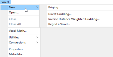

You can create a Voxel using the Voxel > New menu options located on the main toolbar in the current project or the Voxel > New Voxel menu options located on the main toolbar in the 3D Viewer.
The menu offers
The Kriging method best suits clustered data occurring in a region with otherwise sparse data distribution, such as geochemistry data.
The Direct Gridding method on the other hand should be used to grid data uniformly and densely sampled throughout the region, such as GPR or seismic data.
The Inverse Distance Weighted Gridding method is most suitable for gridding data collected along specific directions - such as borehole data.
