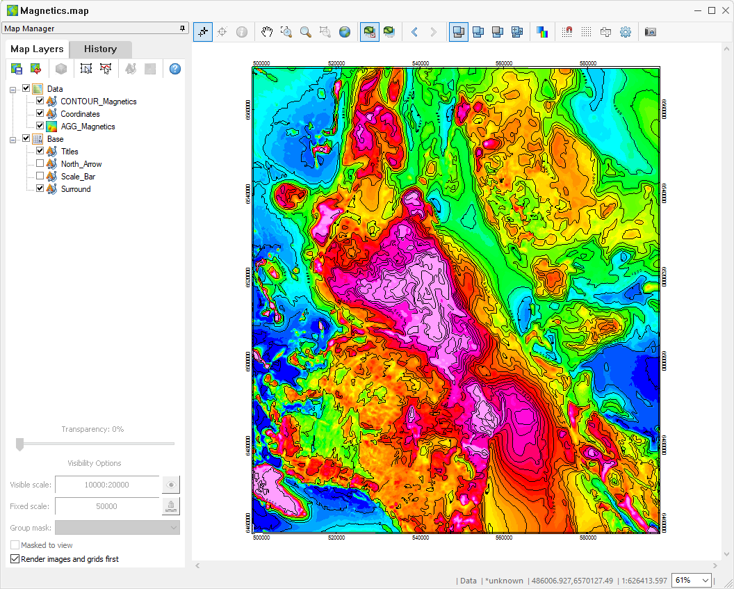

When you create or open a map in Oasis montaj, the system displays a Map window in the project. For a new map, the window is initially empty. For an existing map, all map elements are displayed when the window opens.
After a Map window is open, you can add a wide variety of data and basemap-related information. The Map window provides the basic mechanism for creating maps, images, and linking to other maps and data. Secondly, it provides a means of editing graphics, adding text, and creating highly customized final presentations for output to printers and plotters.

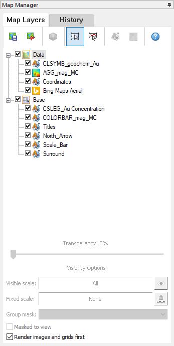

You can use the Map Manager tool o create, edit, move, hide, and mask the groups in each view.
Groups
How do Maps use groups to display information?
You can create, edit, move, hide, and mask groups. You can also move groups in front of and behind each other. Any new object you add to a map, such as a polygon or line, is added to the current group.

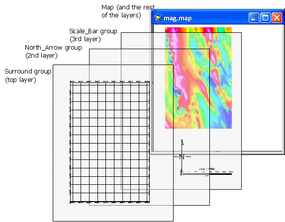

Groups are layered on top of each other in a specific order determined by the Map Manager tool, as shown in the image below.
The graphic below shows how the order in which each group is drawn on the map is determined by the order in the Map Manager.
