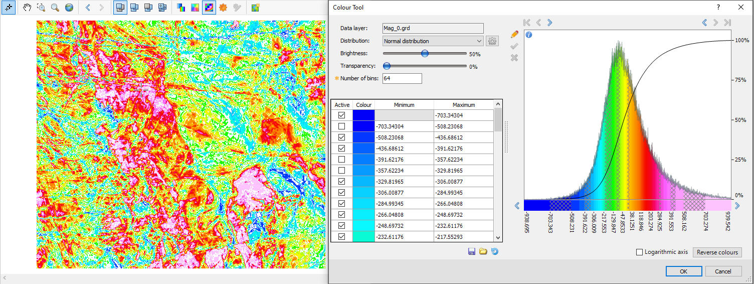

Colour Tool dialog options
Data layer/ |
The name of the selected dataset, data layer, or variable-coloured 2D/3D symbol group. If the selected data layer is a multi-layer aggregate AGG, this field becomes a drop-down list displaying all grid files. This allows you to adjust the color display for individual layers. If the tool was launched with multiple items selected, this field will display "data".
The tool enables you to interactively modify the colour grid zones. The following colour distribution methods for zoning data are available:
Click the Define Distribution Changing the distribution selection will also open the associated colour distribution dialog. The Define Distribution button is disabled when the 'Custom' user-defined distribution is selected. The dataset/data layer is automatically redisplayed using the new colour distribution. The transform graph is redrawn, and the colour bins are updated accordingly. If the tool was launched with multiple items selected, changes will be applied simultaneously to all selected data. |

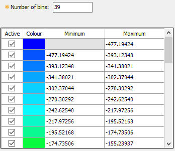

Enter a number for the colour breaks (zones). By default, this matches the number of colour zones in the current colour table. If you enter a different number, the colour table is linearly interpolated or decimated to match the new bin count while preserving the overall colour distribution. For example, if the colour table has 255 levels and you set the number of zones to 15, then only the colours at rows 0,17,34,51, etc., will be used. The number of bins is recalculated when a different colour scheme is loaded using the Open button. The dataset/data layer is automatically redisplayed using the updated colour distribution. The transform graph is redrawn, and the colour bins are also updated to reflect the selected changes. If the tool was launched with multiple items selected, changes will be applied simultaneously to all selected data. |
Bins Colours & Boundary Values |
The bins colours and boundary values are displayed in a scrollable window. If the tool was launched through multiple item selection, the data range is determined by aggregating the values from all selected items. For example, if you select a grid with values from -1 to 10 and a voxel with values from 5 to 100, the combined data range will be from -1 to 100. Activating/Deactivating Bins To hide a specific bin from the image display, simply uncheck its Active* checkbox. This will be visually indicated on the Transform graph using a hashed grey pattern (see Application Notes fro details). To toggle multiple adjacent bins:
Changing Bin Colours The colour distribution of the selected layer is shown in the Colour field. To change the colour of a specific bin:
Editing Boundary Values To adjust the colour breaks, enter new values in the Minimum and Maximum fields* for the desired bin. The adjacent boundary values will be automatically updated to maintain consistency. All changes are automatically reflected in the transform window— both the graph and the colour bar below the horizontal axis of the graph will update accordingly. They are also applied to the dataset or data layer in the active document (e.g., map, grid, 3D view, voxel). If the tool was launched with multiple items selected, the changes will be applied simultaneously to all selected data. Ensure the grid image reflects the updates by enabling the Auto Recolour Grid option. |
Transform Window |
The Transform window displays the binned data distribution of the current data layer/symbol group using the selected colour zoning method. If the tool was launched through multiple item selection, the displayed histogram represents an aggregate of all selected items: the data range is obtained by aggregating the values of all selected items. (For example, if a grid ranges from -1 to 10 and a voxel from 5 to 100, the combined data range will span from -1 to 100.) All data values are weighted equally. The grey profile traces the number of points within each bin at a finer resolution. The black profile represents the cumulative number of points as a percentile, annotated along the right vertical axis. When the cursor is inside the transform graph, a set of normal dashed lines indicates the range of the zone at the cursor location (see the Application Notes below). The colour bar below the horizontal axis of the graph is annotated with the absolute values of the bin boundaries. Hovering over the colour bar displays a tooltip with the name of the current colour scheme. This tooltip will not appear after modifications such as changing the distribution, reversing colours, adjusting the number of bins, or resizing colour bins in the colour bar. Resetting the changes (Reset button) will restore the tooltip functionality.
Interactive FeaturesTo visually enhance features of interest, a number of interactive options are provided to scroll, zoom, and modify the number, colour, and size of bins. All changes are automatically applied to the transform window, colour bins, and the data layer/symbol group in the active document and any related image (AGG). However, these changes are not committed to the map until you save the map. If the tool was launched via multiple item selection, changes apply simultaneously to all selected data.

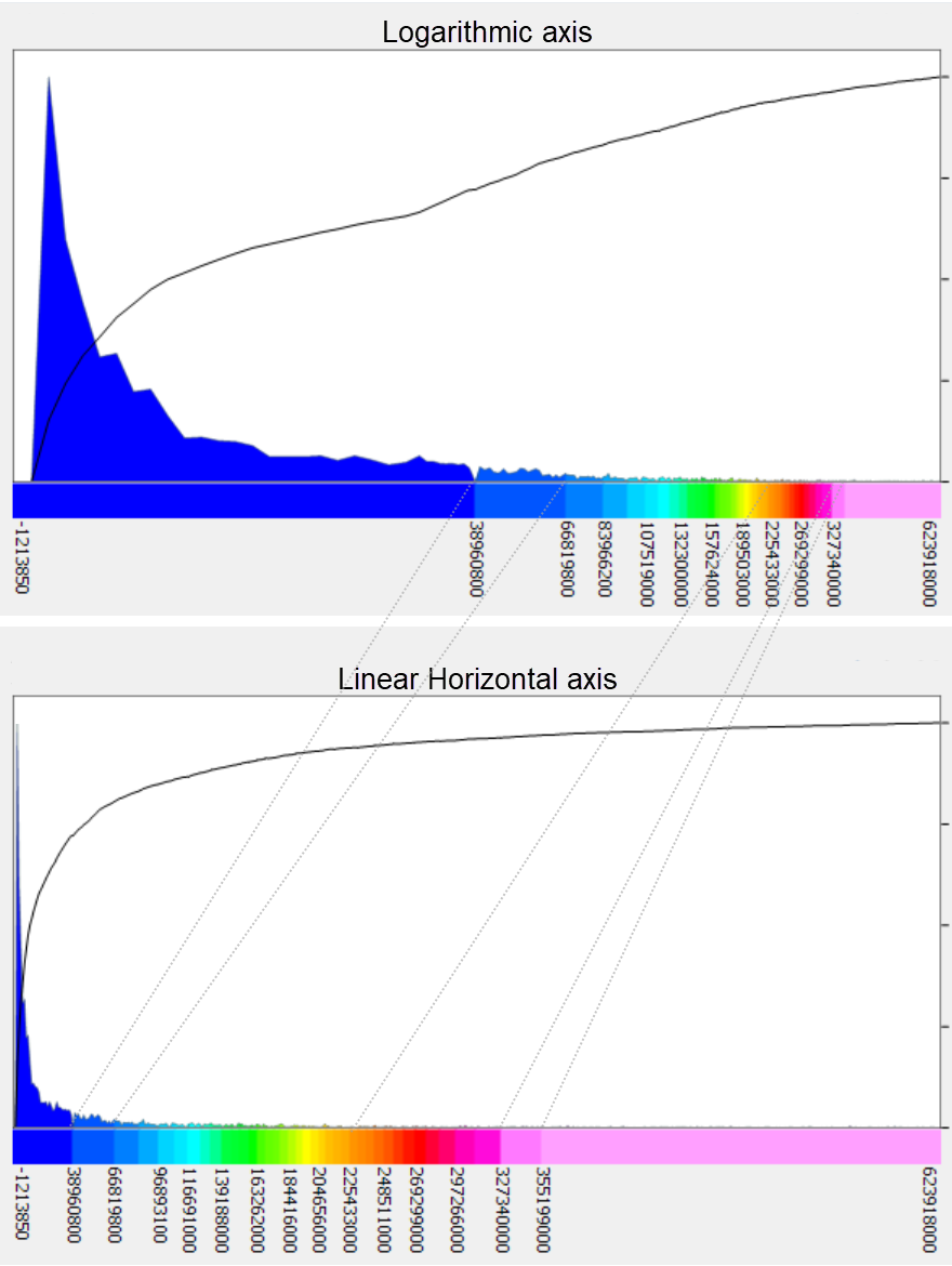

Logarithmic axis |
Leave this option unchecked if your data follows a Gaussian distribution. Enable the Logarithmic axis option when your data spans several orders of magnitude and a significant portion of values lie near the lower end of the scale. Using a logarithmic scale enhances the visibility of low-value data in the transform graph, revealing finer details. This setting only affects the transform graph (both the graph and profile are redrawn). It does not alter the data bins or the data layer/colour symbol in the active document (e.g., map, grid, 3D view, voxel).

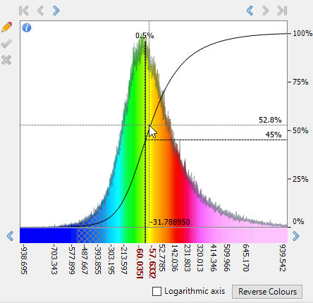

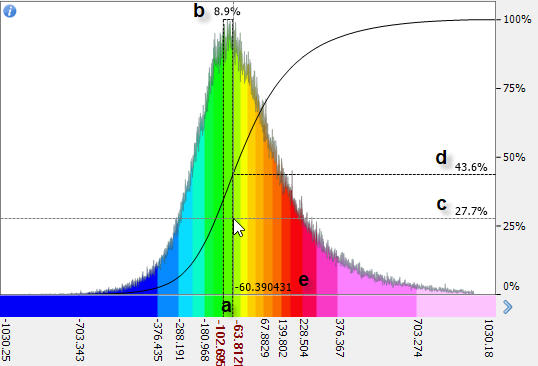

Transform Graph Annotations
The cursor’s position within the transform graph window is continuously tracked and annotated to provide real-time feedback. At the cursor location, the following visual cues and data are displayed:
a – The bin under the cursor is outlined with dashed lines, and its edge values are shown in bold.
b – The percentage of total data values contained within the highlighted bin is displayed at the top of the dashed lines.
c – The cumulative percentage of data values up to the highlighted bin is annotated along the right-hand axis.
d – The percentile value corresponding to the exact cursor location is also shown along the right-hand axis.
e – The grid value at the cursor’s horizontal position is annotated along the bottom axis.

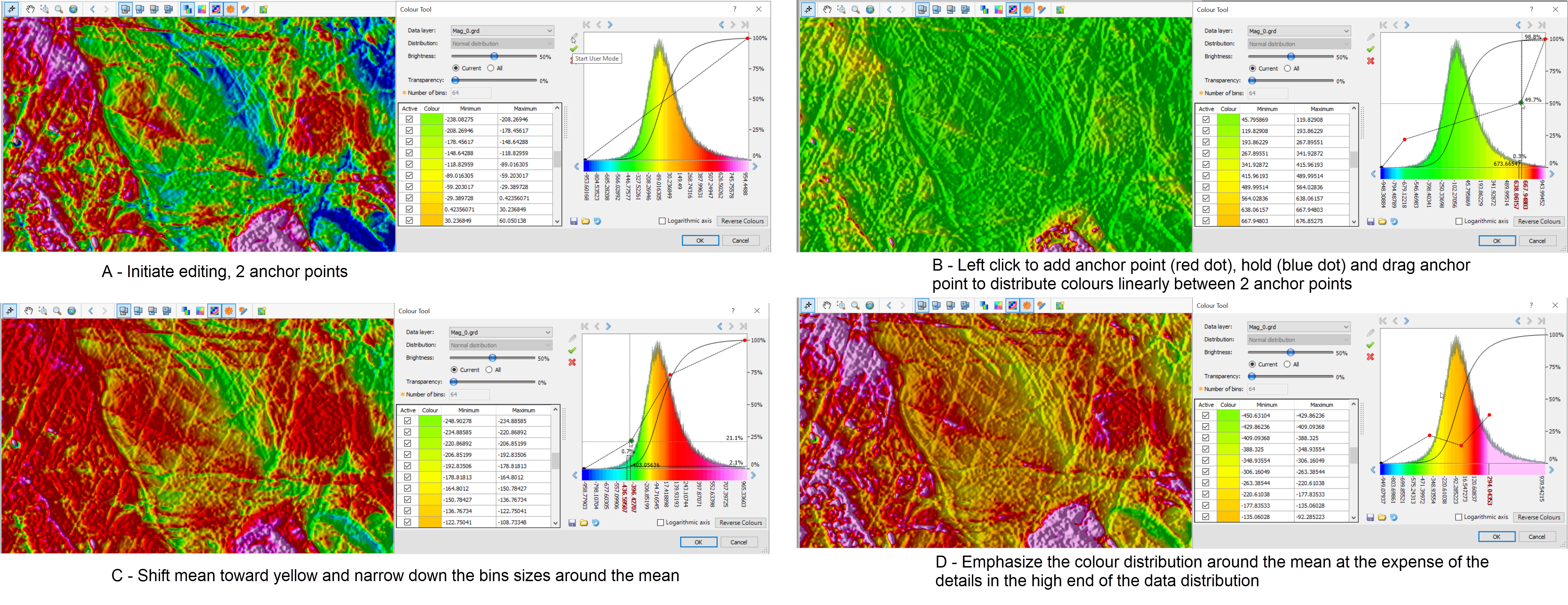

Custom Colour Distribution
When entering User Mode,
, the bins are initially set to span linearly across the entire data set. This is indicated on the transform graph with a straight dashed line with two anchor points (A).
You can add additional anchor points by clicking on the graph (red dot).
The horizontal position of the added anchor point selects the bin
The vertical position of the cursor controls the colour that will be assigned to the bin.
Subsequently, all bins located to the left and right of the cursor location, up to the next anchor point, will be linearly assigned new colours.
To move an anchor point, move the cursor on the anchor point until it changes to a blue dot (B). Then, left-click it and drag it to a new position.
You can augment the size of the final bin by simply grabbing its anchor point and moving it (D).
Once you're satisfied with the colour distribution, click
to apply the new settings (and save the new distribution).
