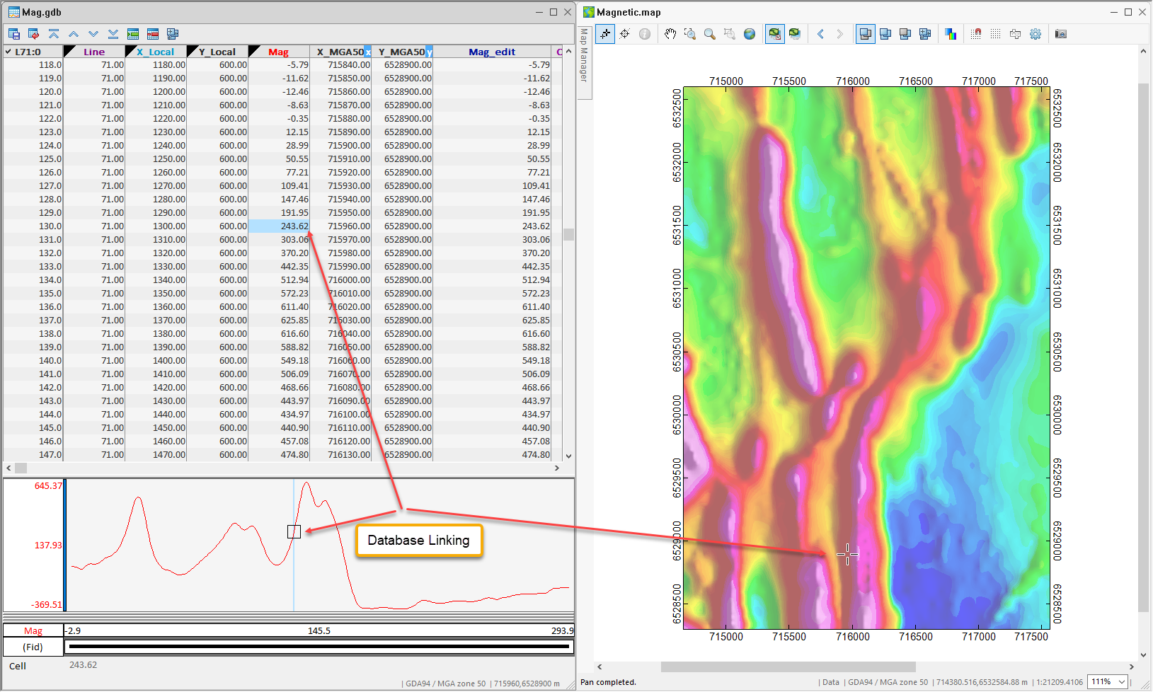

At the most basic level, you can use dynamic linking to link spreadsheet data and profiles. When you work with Spreadsheet and Profile windows and select one or more cells in the Spreadsheet window, the system automatically shows you and locates the corresponding data in the Profile window (or vice versa).
When you work with Spreadsheet, Profile, and Map windows and select a point (cell) in the Spreadsheet or Profile window, the system automatically highlights the corresponding "Shadow Cursor" location in the Map windows.
You can access the data linking tools on the Map navigation toolbar:
  • When the Shadow Cursor button is selected, and you select a point on a map, that same location is highlighted with a "Shadow Cursor" on the other open maps and grids. In addition, in any open database (spreadsheet and profile) the closest point in the currently visible line/group is highlighted.
  • When your spreadsheet data has multiple lines or groups, select the Data Linking button and then select a point on the map, the cursor will ‘snap to’ the nearest data point, and this location is highlighted with a “Shadow Cursor" on the other open maps and grids. In the linked database (spreadsheet and profile) that data point is highlighted automatically, changing the visible line/group as required.
  • To use the Data Linking button and link to a database, your map must contain line/group linking items (e.g., survey lines, symbols, downhole sections, or an ArcGIS LYR/LYRX file).
You can also create links between map extents (i.e. panning and zooming for multiple maps will occur simultaneously). This functionality is enabled via the Change Extent tools (), on the Map navigation toolbar. For example, to ensure that the cursor location on all maps is always in view, activate the last button in this group: Pan to Cursor on All Maps.
Every time a location is selected on a map using either the Shadow Cursor or the Data Linking tools, the location shadow cursor on the other maps is updated. When the Pan to Cursor on All Maps option is enabled, and the shadow cursor moves out of view, the map will automatically pan to centre on the new cursor location, always keeping the shadow cursor in view.
