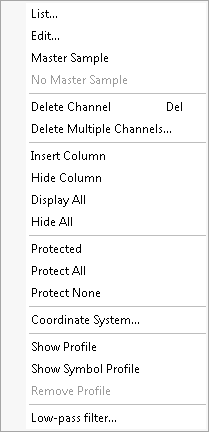

Select the object (database channel, grid, or map) to work with. Right-click, and a context menu, similar to the one shown below for a database channel, will be displayed.
If a process (GX) has been applied to the object, the system appends the corresponding GX to the context menu, at the bottom of the list. In this case, a low-pass filter was applied to a database channel.
Select the GX entry. The system displays the corresponding dialog and the processing settings that were used on the object.
