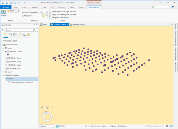

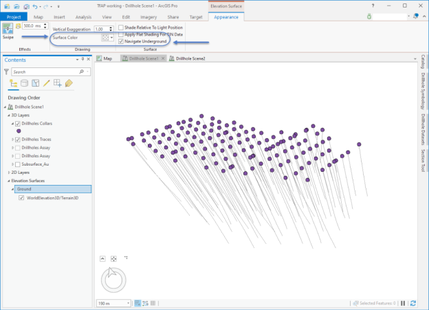

The Configure Scene for Subsurface Navigation tool makes the following changes to the Ground Elevation Surface of the active local scene:
Local Scene before Configuration:
Local Scene after Configuration :
