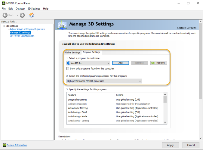

  • Check graphics card settings - high performance graphics drivers often have a dedicated Control Panel application that provides control of graphics driver settings. If you have a high performance graphics driver, open the Control Panel and explore the 3D settings that you can use to configure ArcGIS Pro for maximum performance. The example below illustrates how to customize the ArcGIS Pro application on a computer with an NVIDIA graphics card driver: the preferred graphics processor for the ArcGIS Pro application has been set to the High-performance NVIDIA processor.

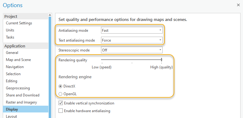

For maximum performance with high volumes of subsurface data, you can adjust the following display settings within ArcGIS Pro:
  • Antialiasing - experiment with the Antialiasing mode options (by example, you might notice that "Normal" reduces the amount of smoothing in rendering but increases performance), and turn off Text antialiasing.
  • Rendering quality - adjust to optimise for speed rather than quality. Switch the setting to the opposite and do a few basic tasks: if it seems faster, keep it this way; if you experience slower behaviour, revert to the previous setting. Note that the optimum setting will depend on your computer graphics card.
  • Rendering engine - choose the appropriate engine for your machine.
You can modify these settings in the Options dialog box: click the Project tab (or on the ArcGIS Pro start page, click the Settings button in the lower left corner), and in the list of menu items on the left, click Options and then Display.

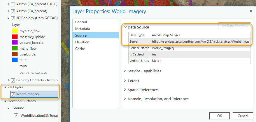

  • Turn off web hosted layers when internet is slow - identify which layers in your project are from a web/online source, and turn off or remove these layers if your internet connection is slow. Look out for basemap layers, elevation service layers, etc.:
