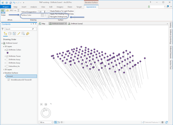

The Configure Scene for Subsurface Navigation tool makes the following changes to the Ground Elevation Surface of the active local scene:
  • Enables the underground navigation option
  • Sets the Ground Elevation Surface as transparent (instead of any opaque color) so that you can see through to the subsurface more easily

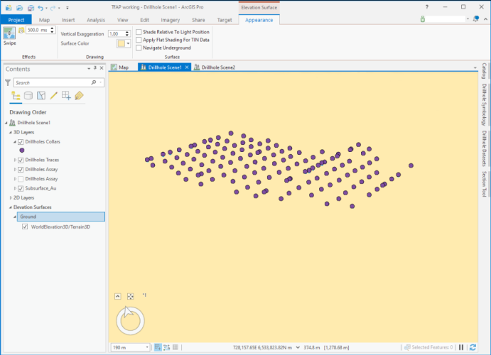

Local Scene before Configuration:
Local Scene after Configuration :
