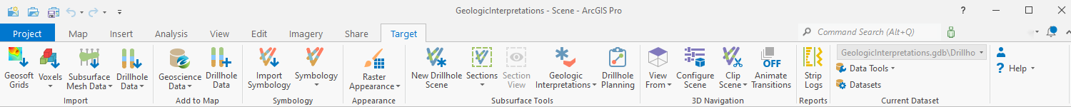

Hover the cursor over the image below and click to see a full-size image of the Target tab:
