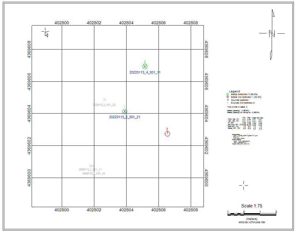

Summary Map
The Data view of the map will contain
four separate groups:
- Seeds: marked with symbols that are rotated to match the calculated seed-source azimuth and labeled with the Seed Id (above centered):
- Seeds_Detected (Pass): green circle symbol rotated to match the calculated seed-source azimuth and labeled with the Seed Id
- Seeds_NotDetected (Fail): red circle symbol rotated to match the calculated seed-source azimuth, and labeled with the Seed Id
- Sources: marked with symbols and labeled with the Seed Id (below centered):
- Sources_Seeded: blue circle symbol (75% of the seed symbol size) and labeled with the Seed Id
- Sources_NonSeeded: grey circle symbol (50% of the seed symbol size) and labeled with the Seed Id

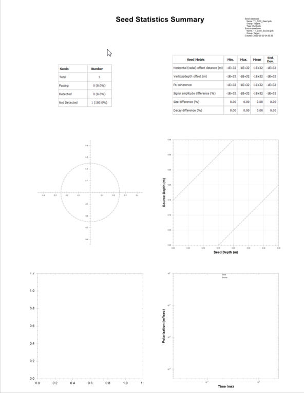

Summary Report Plot
The plot will report on the following
summary items:
- Title: "Seed Statistics Summary"
- File details and date:
- Seed database
- Name
- Group
- Type (e.g., Quality Control)
- Source database
- Name
- Group
- Created: YYYY-MM-DD, hh:mm:ss
- Summary
- Total number of seeds
- Number and percentage of seeds (detected)
- Number and percentage of seeds (not detected)
- Number and percentage of seeds (passing)
- Number and percentage of seeds (passing) on the dig list
- Table of statistics - Minimum / Maximum / Mean / Standard Deviation for:
- Horizontal (radial) offset distance (m)
- Vertical/depth offset (m)
- Fit coherence
- Signal amplitude difference (%)
- Size difference (%)
- Decay difference (%)
