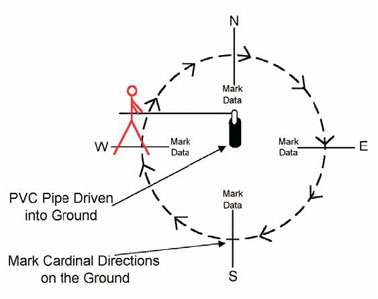

An "Azimuthal Test" can be performed to document the differences in readings based on the sensor’s orientations. It is recommended that this test be performed for all proposed magnetometer configurations. A pictorial illustration of the "Azimuthal Test" is seen in Figure 1.
Figure 1. Pictorial representation of the Azimuthal Test.

- Identify an area free of cultural sources of geophysical noise. When this test is performed near a magnetic gradient, small shifts in the sensor head position will produce large variations in the total field values.
- The sensor must be maintained in a fixed position while the operator revolves slowly around it. Placing the sensor head through a hole in the top of a non-magnetic table or into the top of a vertical section of PVC pipe will help to stabilize it.
- Mark the four cardinal directions on the ground using pin flags or marking paint. Recording fiducial marks at the moment the operator is facing cardinal directions will aid in determining the heading error for particular survey line directions.
- Using a fully warmed-up instrument, begin data collection while facing north, and slowly move in a clockwise circle, pivoting around the table or PVC pipe. Place a marker (fiducial) in the data when reaching each of the cardinal directions. These markers will be used to plot the direction the operator was facing as data points were collected.
- Different orientations may need to be evaluated to minimize any observed deviation in amplitude or any magnetic "dead zones" that are encountered.
