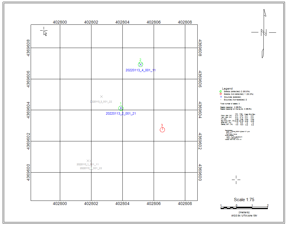

| Create map | Check this option to create a summary map (.map) file. See the Application Notes below for more details. Script Parameter: UX_CALCULATE_SEED_STATISTICS.CREATE_MAP [0: No | 1: Yes (default)]
| Name | Enter a name for the output map or select an existing map file (i.e., click the browse button [...] or expand the drop-down list). Script Parameter: UX_CALCULATE_SEED_STATISTICS.OUTPUT_MAP_NAME | ||||||||||||||||
| Map template (page) | Select a standard template to be used to define the map layout. The map layout includes the media size, map margins, and a basic map drawing style. This field is disabled when the Existing map option is selected. Script Parameter: UX_CALCULATE_SEED_STATISTICS.MAP_TEMPLATE_NAME | ||||||||||||||||
| Map scale |  Use the calculator button ( Script Parameter: UX_CALCULATE_SEED_STATISTICS.MAP_SCALE | ||||||||||||||||
| Map symbol size | Specify the seed symbol size in mm. Script Parameter: UX_CALCULATE_SEED_STATISTICS.MAP_SYMBOL_SIZE | ||||||||||||||||
| Plot non-seeded sources | Select this option to plot the locations of sources that do not match the seed items. Script Parameter: UX_CALCULATE_SEED_STATISTICS.PLOT_NON_SEEDED | ||||||||||||||||
| Plot legend | Check this option to plot a legend on the map. Script Parameter: UX_CALCULATE_SEED_STATISTICS.PLOT_LEGEND [0: No | 1: Yes (default)]

Summary Map
The Data view of the map will contain
four separate groups:
- Seeds: marked with symbols that are rotated to match the calculated seed-source azimuth and labeled with the Seed Id (above centered):
				- Seeds_Detected (Pass): green circle symbol rotated to match the calculated seed-source azimuth and labeled with the Seed Id
- Seeds_NotDetected (Fail): red circle symbol rotated to match the calculated seed-source azimuth, and labeled with the Seed Id
- Sources: marked with symbols and labeled with the Seed Id (below centered):
				- Sources_Seeded: blue circle symbol (75% of the seed symbol size) and labeled with the Seed Id
- Sources_NonSeeded: grey circle symbol (50% of the seed symbol size) and labeled with the Seed Id
The Base view Legend group will contain the
following items:
- Number and percentage of seeds (detected)
- Number and percentage of seeds (not detected)
- Number of sources (seeded)
- Number of sources (non-seeded)
- Total number of seeds
- Number and percentage of seeds (passing)
- Number and percentage of seeds (passing) on the dig list

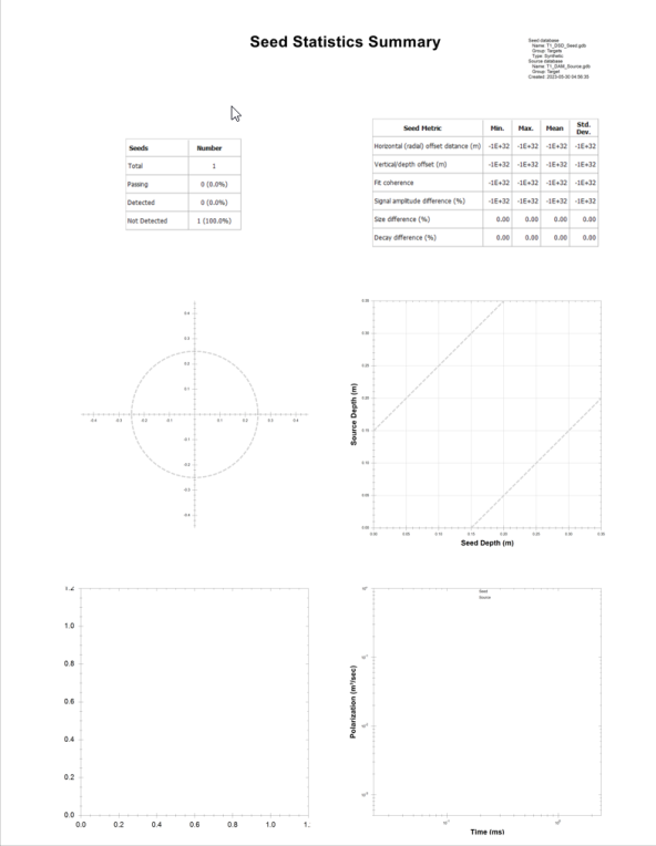

Summary Report Plot
The plot will report on the following
summary items:
- Title: "Seed Statistics Summary"
- File details and date:
- Seed database
- Name
- Group
- Type (e.g., Quality Control)
- Source database
- Name
- Group
- Created: YYYY-MM-DD, hh:mm:ss
- Summary
- Table of statistics - Minimum / Maximum / Mean / Standard Deviation for:
- Horizontal (radial) offset distance (m)
- Vertical/depth offset (m)
- Fit coherence
- Signal amplitude difference (%)
- Size difference (%)
- Decay difference (%)
