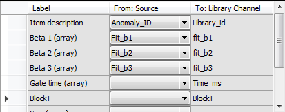

Channel mapping
Pick the corresponding source channels for the required library channels, add new source-library channel pair, or remove existing pairs.
Here is the list of required channels, which are specified by non-empty labels:
  • Item description
  • Beta 1
  • Beta 2
  • Beta 3
  • Gate time
  • BlockT
  • Size
  • Decay
  • Date (IVS mode only)
  • Time (IVS mode only)
  • Fit X (IVS mode only)
  • Fit Y (IVS mode only)
  • Fit Z (IVS mode only)
In order to remove a row, select the row by clicking on the first column, then, hit Delete key:
  • If the row is in edit mode, it has to be set to select mode first before deleting. In order to change the status, click on another row.
    The edit mode is recognized by icon displayed in the first column.
  • Script Parameter: UXANALYZE.CHANNEL_MAPPING
