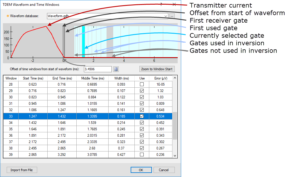

TDEM Waveform and Time Windows
Use the TDEM Waveform and Time Windows tool to specify the time gates to be modelled along with the noise levels for each.
TDEM Waveform and Time Windows dialog options
Waveform definition |
The waveform specification can contain either the name of the source database or a comma separated list of defined parameters. |
Offset of time windows from start of waveform |
The offset of the designated shutoff time from the beginning of the waveform. The first EM gate containing data may be further offset from the shutoff time.

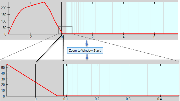

[Zoom] |
Press the button to enable a 20x zoom toggle that magnifies the time scale around the first receiver time window. Press again the button to go back to full view. |
Import Time Windows from File |
The time gates can also be read from a file – see Application Notes below. |

You can easily view and modify your current waveform definition in VOXI Manager:
- In the Data tree, hover the cursor over Windows and Waveform and a tooltip will display your waveform specification if defined.
- Right click Windows and Waveform, then click on Modify:
- If no waveform has been defined yet, the Specify TDEM Waveform dialog will open first in order to define your waveform data for the inversion.
- If the waveform has been defined, TDEM Waveform and Time Windows will open: further modifications to the waveform specification can be made along with time windows selection.

The above two tables are shown on the graph of the waveform dialog (see illustration below). In the illustration, the shutoff time is set at 3.4506 ms. The EM decay array start time 0.018 ms is relative to the shutoff. Thus, it occurs at the absolute time 3.4186 ms. Furthermore, the first few gates are normally not used.
Prior to the inversion, you can further manipulate the settings, for example you could determine which gates are passed to the inversion by checking on/off the Use boxes in the dialog. You can also manually edit the error values.

The Zoom button allows you to zoom in to the start of the Receiver time.
