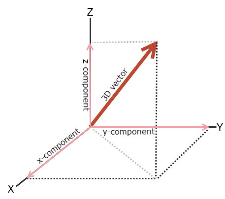

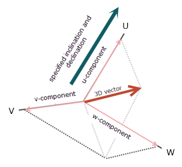

A vector voxel can be disassembled into its 3 components in the standard Cartesian coordinate system, or a rotated coordinate system. In the standard Cartesian coordinate system, the projected voxels are denoted as the X, Y, & Z component voxels. The X component is analogous to Easting, the Y component analogous to Northing and the Z component direction is upwards positive. In the rotated coordinate system, the projected components are denoted as U, V, & W. The U component is positive in the direction of the rotated coordinate system’s inclination and declination, the V and W components are perpendicular to U and to each other.
If the rotated coordinate system direction is embedded in the vector voxel file (i.e. the output of a VOXI Magnetization Vector Inversion) you will be given the option to choose between the above two coordinate systems, otherwise you will only be able to project the vector voxel onto the standard Cartesian coordinate system.
Figure 1: 3D Vector displayed with respect to Cartesian coordinates; Z is upwards positive
Figure 2: 3D vector displayed with respect to rotated coordinates; U is positive in the direction of the specified inclination and declination
