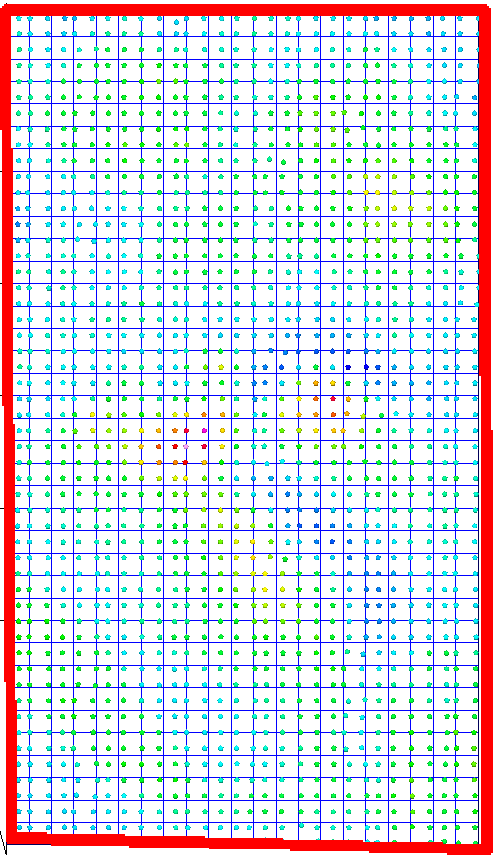

Optimize data sampling |
If relative to the size of the voxel model element, the data it is too highly sampled, sending all the observed data to the inversion adds no value, but slows down the process. You can decimate the data with little to no loss of precision and thus speed up the process. By default, the data will be decimated to yield roughly one sample per surface voxel element. (see Figure 1). |

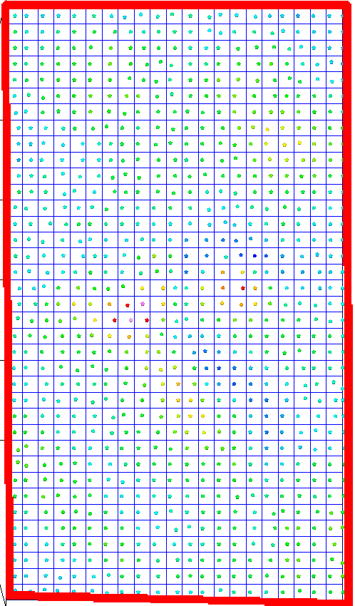

Samples per cell |
The number of samples per horizontal cell is customizable. Prior to modelling, all observations and their positions within the same horizontal cell are averaged to yield the required number of samples per cell (see Figure 2). |

Figure 1: One sample per cell
Figure 2: Two samples per cell
