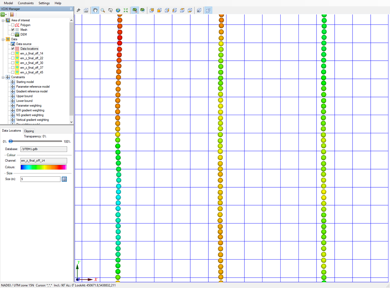

Figure 1: Airborne TDEM example with 10 samples per cell

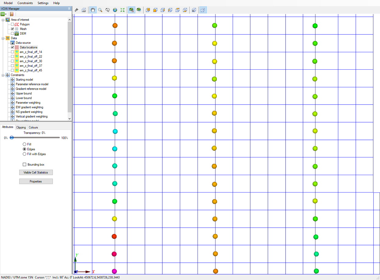

Figure 2: Airborne TDEM example with one sample per cell
It is not advisable to have too many samples per cell, as it increases the computation time without a noticeable gain in the outcome.
