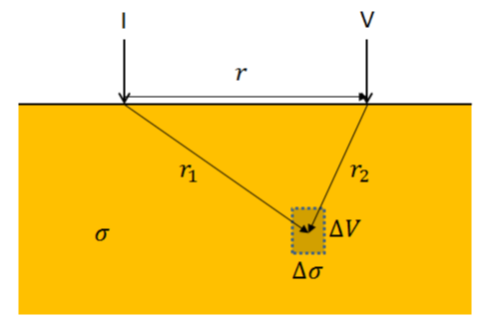

The measured data is decimated using the simple notion of dropping data which exerts little impact on the inversion process. To illustrate the approach let’s consider a uniform halfspace earth with conductivity σ and a small conductivity perturbation σ+Δσ in the sub-volume ΔV.
Figure 1: A uniform half space model with small conductivity perturbation.
The potential V(r) can be expressed as:
The sensitivity of a measurement in the sub-domain ΔV to the change in the conductivity is:
Which is indicative of the effect that each measurement exerts on a voxel volume ΔV. For each current electrode(s), the larger the distance of the potential electrode(s) from the sub-domain, the smaller it’s impact.

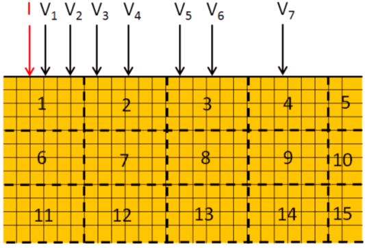

In the schematic illustration of Figure 1.2 the current is injected at electrode I and the resulting potential is measured at the potential electrodes V1 through V7. For simplicity the Y coordinate is omitted.
If the voxel model is subdivided into sub-domain boxes of dimensions X,Z=6,4, as indicated by the dashed lines, the most impactful measurements in box 1 in order of importance are V1 then V2.. In box 2 V4 then V3, and in box 3, V6 then V5.
In this case a winnowing process that retains 1 measurement in each 6x4 sub-domain will winnow V2, V3, V5 and pass V1, V4, V6, V7 to the inversion process.
This process is repeated for every current location and easily generalized to more complicated electrode distributions.
Figure 2: A voxel model subdivided into boxes under a pole-pole survey.
The percentage of the retained measurements sent to the inversion is reported in the log file under Important data. Furthermore the number of retained measurements and the number of winnowed measurements are also reported in the log file under Parameters.
