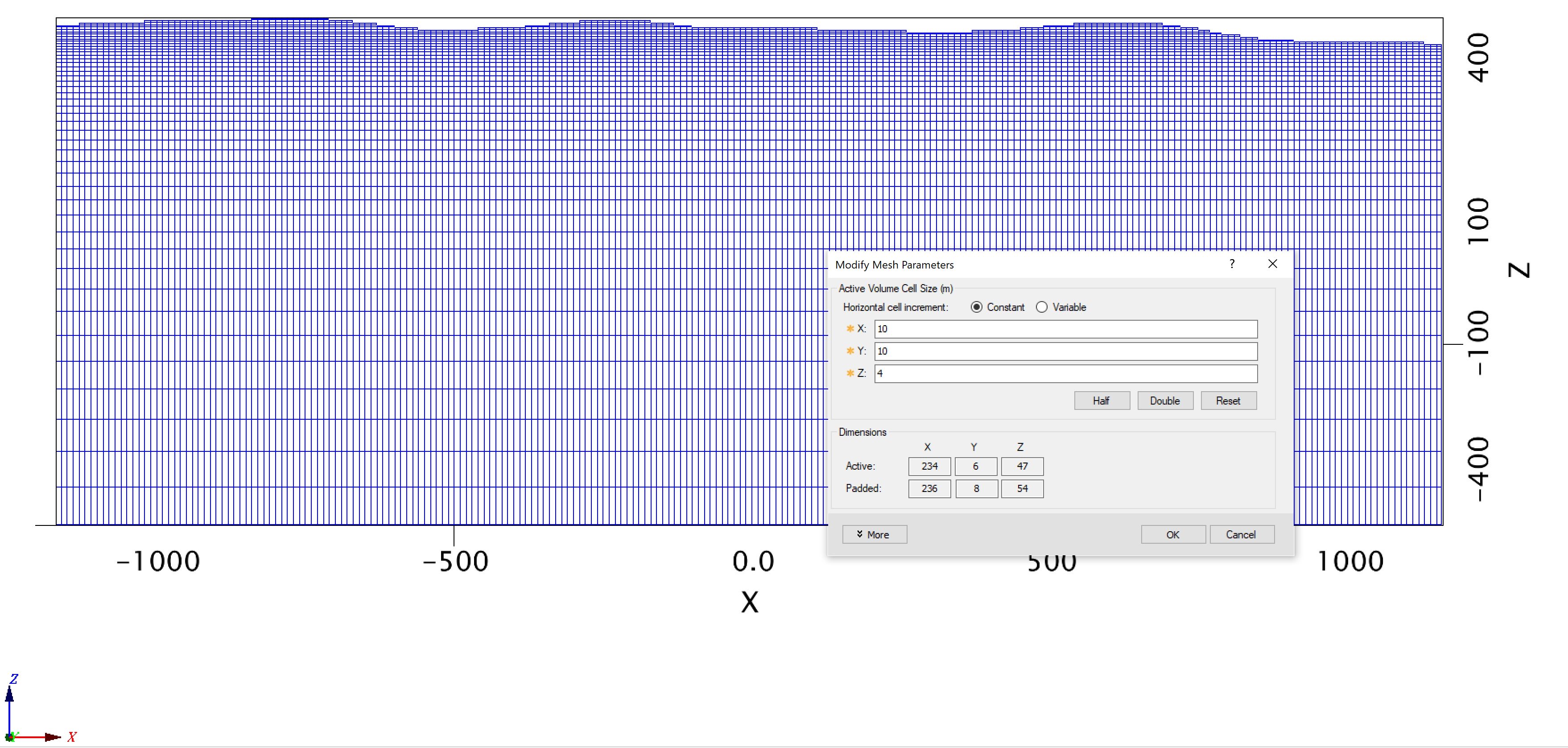

Figure 1: Constant horizontal cell increment of 10 m

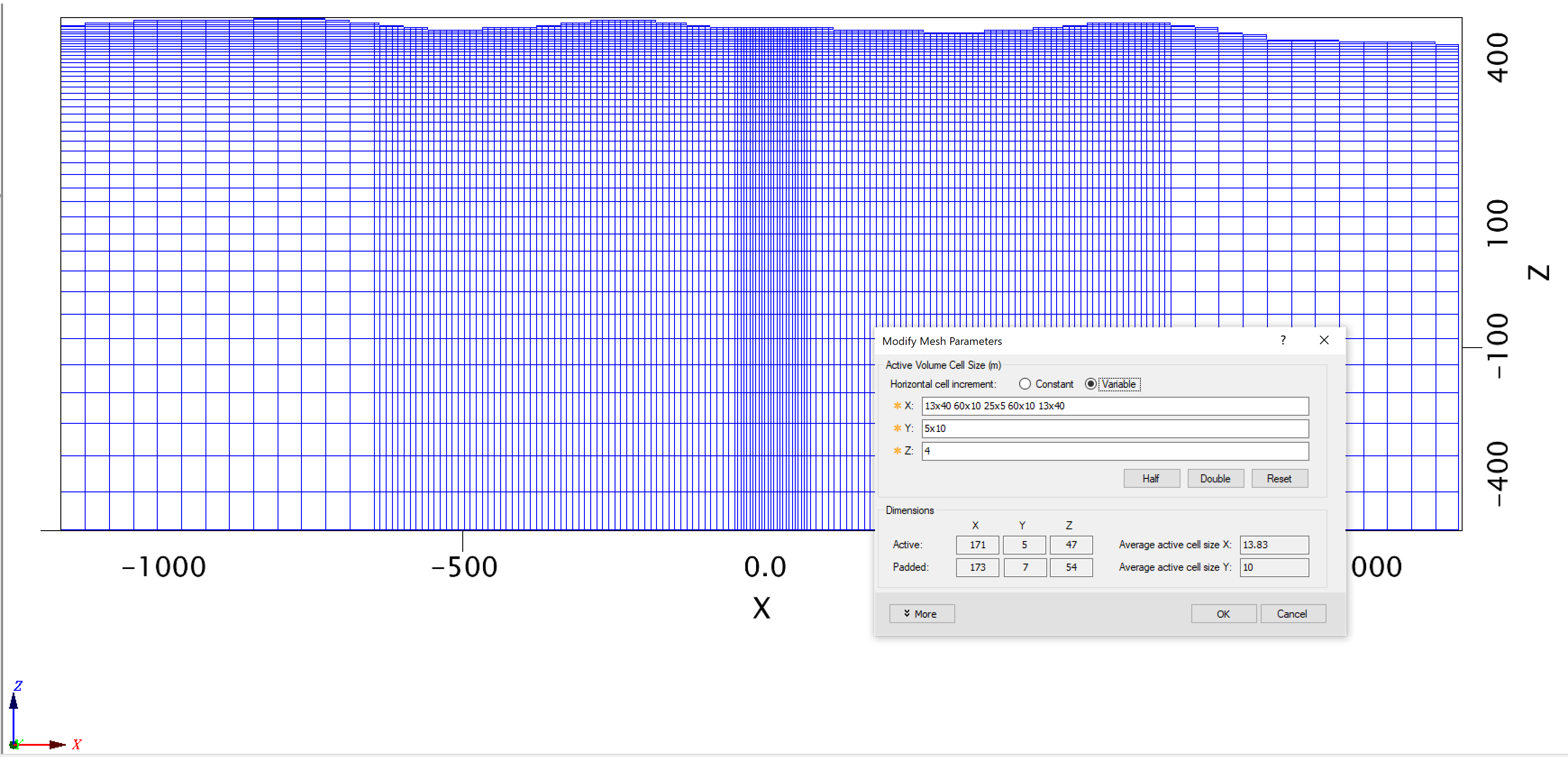

Figure 2: Variable horizontal cell increment
