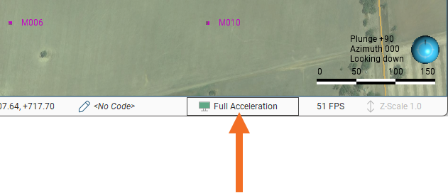

The acceleration mode can also be changed by clicking the button at the bottom of the Leapfrog Viewer main window:
