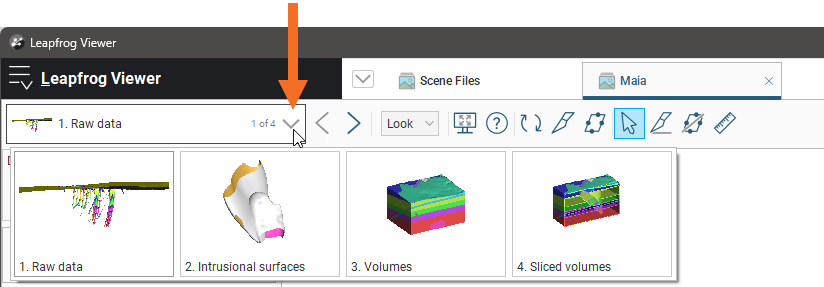

Click the scene list to view thumbnails of all the scenes in the file, or use the arrows (![]()
) to display each scene:

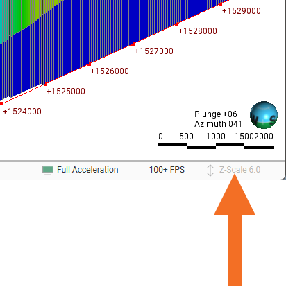

The Z-Scale setting (
) shows the scaling of the Z-axis relative to the X- and Y-axes. When the scene file was created, the z-scale may have been set to a value that accentuates height data. For example, this scene has been set to a Z-Scale of 6.0:

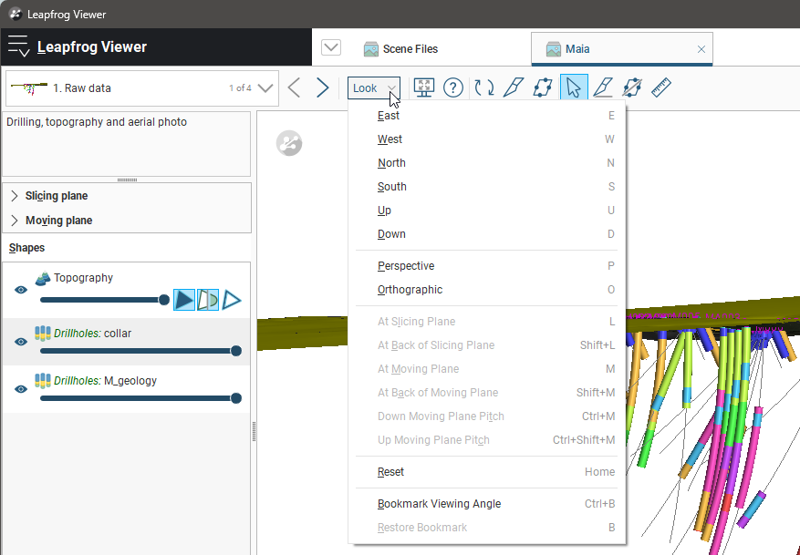

The current viewing angle and scale are displayed in the lower right-hand corner of the scene. Use the Look menu in the toolbar to switch to the different viewing angles:
If you prefer to navigate using the keyboard, use the keyboard shortcuts shown in the Look menu.

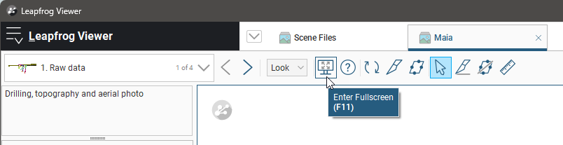

You can display the scene window full screen by clicking on the Fullscreen option in the toolbar (
If you have more than one screen attached to your computer, you will be asked which screen to use:
You can display the scene on the larger screen and work with the available objects and scenes on the smaller screen.
Fullscreen mode is useful for presentations with a projector. Select the projector as the full screen monitor, and you will be able to run Leapfrog Viewer from the other screen.

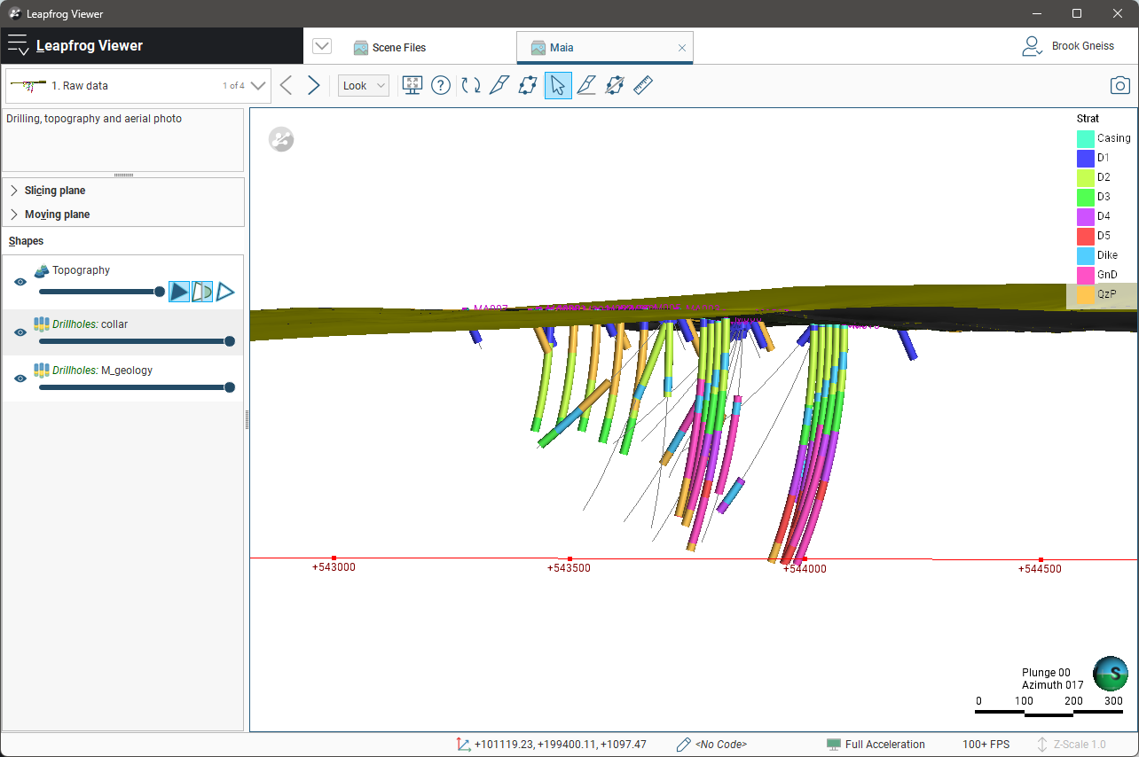

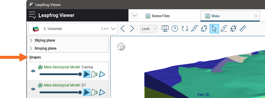

Use the controls in the Shapes panel to change how objects are displayed in the scene:

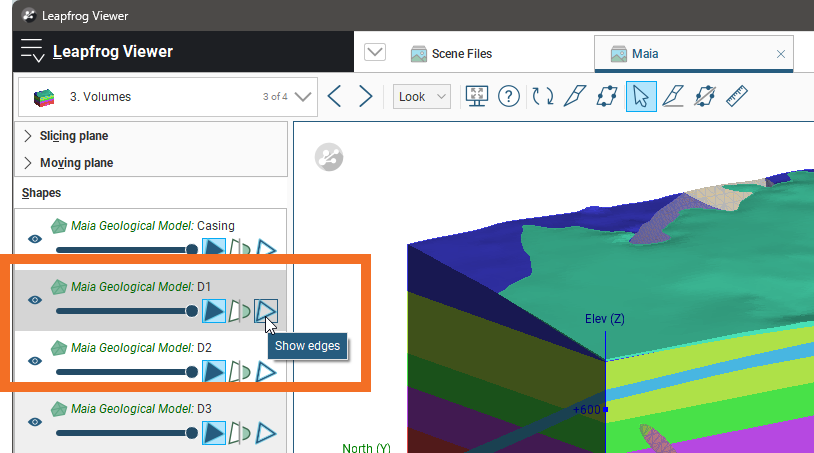

You can hide objects by clicking on the Show/Hide button (
) and change the opacity of objects using the sliders. Different controls are available to change how the different shapes are displayed. To see what each control does, hold the cursor over it to see the tooltip:

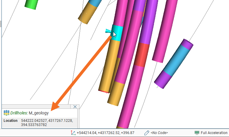

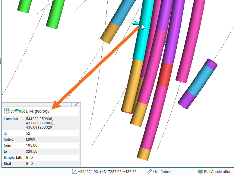

When you click on an object in the scene, a popup window will be displayed showing information about the object. If data was included when the scene was created, this will be displayed in the scene. For example, here we can see the selected data point’s location, identification, starting and ending points and lithology:
If no data is available, only basic location information about the selected shape will be displayed. Here, only the data point’s location is shown:
