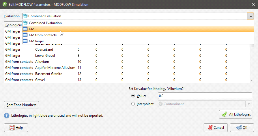

If more than one object has been evaluated on the grid, you can set hydrological properties separately for each evaluation. Select the required evaluation from the Evaluation list:
However, the only hydrological properties information that will be exported is that set for the evaluation to be exported.

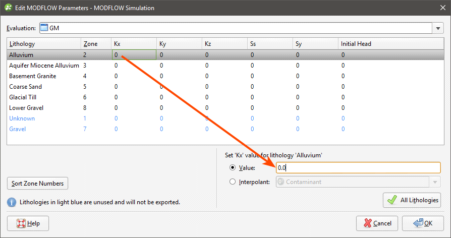

Setting Hydrological Properties

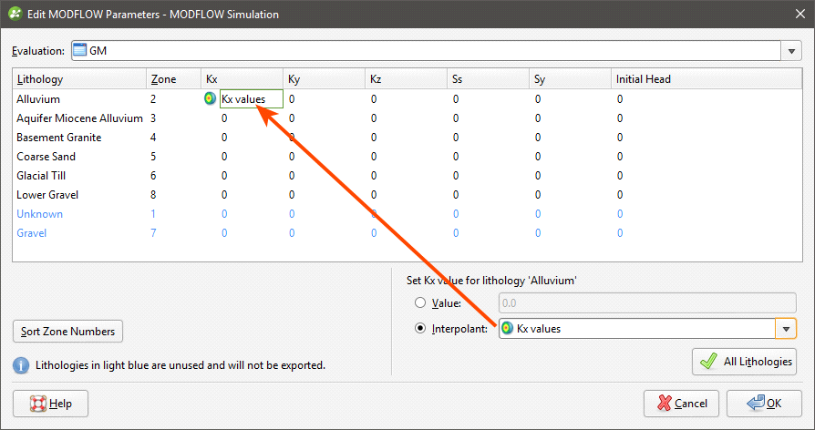

In the Edit MODFLOW Parameters window, you can enter the values for hydrological properties manually or you can use the values from an interpolant.

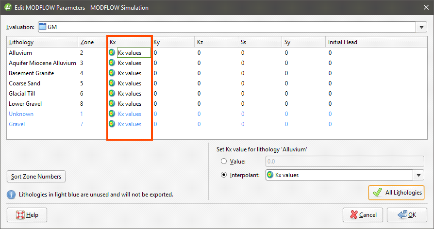

To use the interpolant for all the values in the selected column, click the All Lithologies button. The window will be updated to show that the interpolant values will be used for that column:

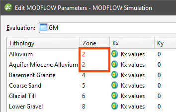

When the model is exported, the zone numbers are used to indicate the assignment of lithologies to blocks and are written to the MODFLOW zoned layer properties flow (*.lpf) file. In the Edit MODFLOW Parameters window, you can change the zone number for a lithology by clicking in a cell and entering a different zone number. If you reorder the zones in this way, zone number conflicts will be highlighted in red:
Zone numbers must be unique and you will not be able to close the window and save data if there are conflicts.
