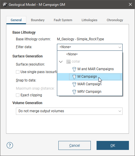

Changing the Query Filter
Although the Base lithology column cannot be changed once a geological model has been created, you can change the filters applied to the data. Any filters defined for the lithology table used to define the model can be applied to the Base lithology column:

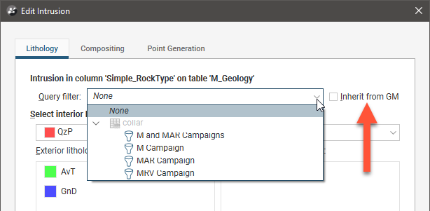

Individual surfaces in the geological model can inherit the query filter from the parent geological model or can use a different filter. To change what query filter is used for a surface, double-click on the points used to create the surface and change the Query filter setting in the Lithology tab:
You may first need to disable the Inherit from GM option to change the Query filter.
