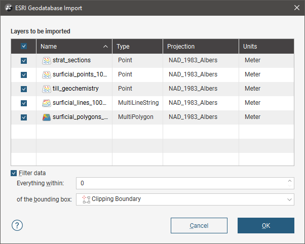

To import GIS points, lines and polygons in this way, right-click on the GIS Data, Maps and Photos folder and select Batch Import > from ESRI Geodatabase. In the window that appears, navigate to the folder that contains the database folder (*.gdb) and click Open.
Leapfrog Works imports uncompressed ESRI geodatabases.
Click OK to import the selected files, which will be added to the GIS Data, Maps and Photos folder as a group (). Data in the group can be reloaded individually or as a group, which is described in Reloading GIS Data.
