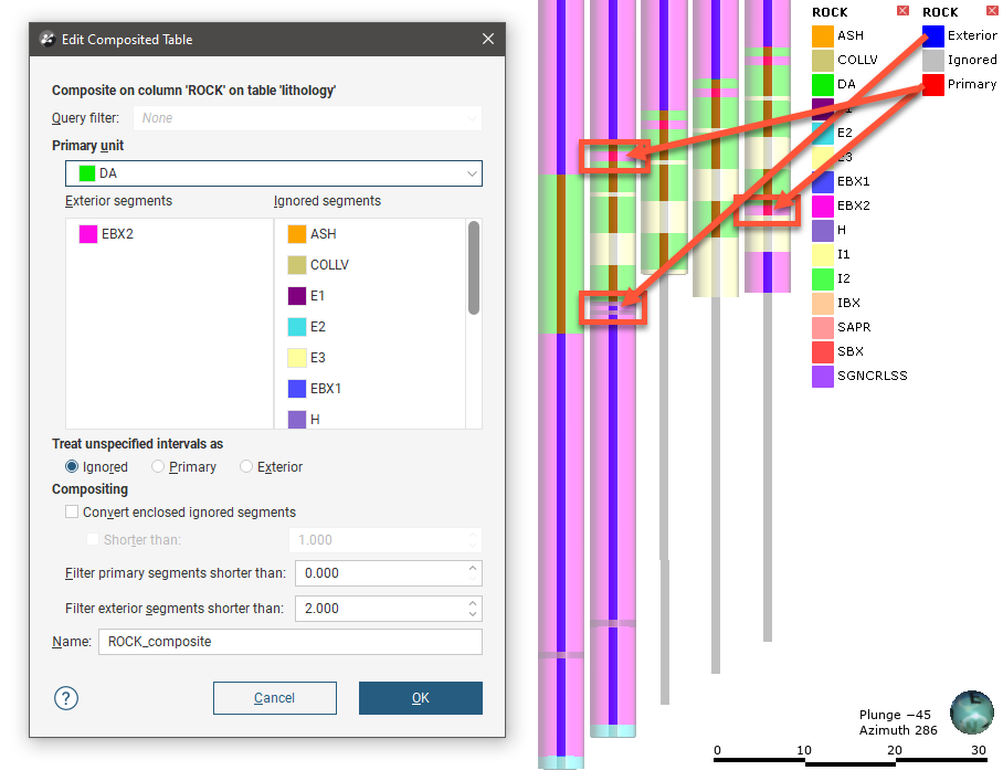

The Filter primary segments shorter than and Filter exterior segments shorter than parameters determine how short a segment must be before it is composited. When the value is set the zero, no segments will be converted.

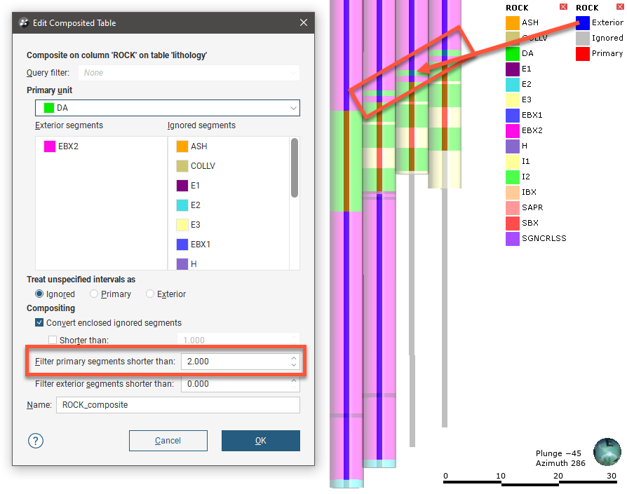

When Filter primary segments shorter than is set to a value, short primary segments adjacent to at least one exterior segment will be converted to an exterior segment.

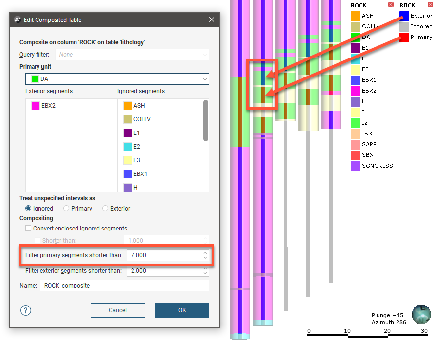

If we increase the length for the filtered primary segment in this illustrative example, we see that if the primary segment does not have at least one adjacent exterior segment, because it is enclosed by ignored segments, then it will not be converted to an exterior segment, even if the length of the segment is shorter than the specified length.
