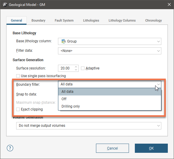

Changing Default Boundary Filtering
When data objects are added to a surface in the geological model, there are two ways to handle the data that lies outside the surface’s boundary:
By default, geological models are created with boundary filtering on for all data used to build the model. This default value can be changed once the model has been created and later, as you build model surfaces, you can also set boundary filtering on a surface-by-surface basis.
To change the default boundary filtering option for a geological model as a whole, double-click on the model in the project tree. The default Boundary filter setting is in the General tab:
Options are:
- Off. Data is not filtered.

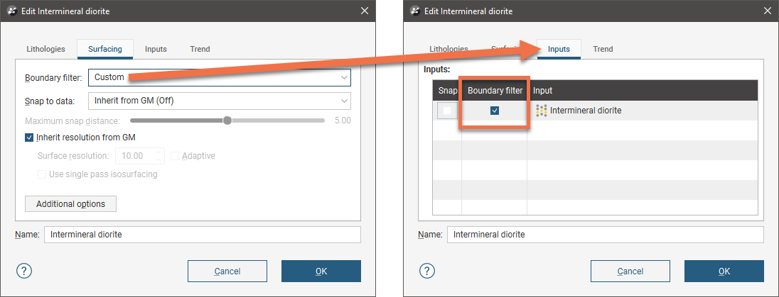

To change boundary filtering for individual surfaces, double-click on the surface in the project tree, then click on the Surfacing tab. Options For Boundary filtering are:
When you choose Custom for individual surfaces, you can select which data to filter from the surface’s Inputs tab.

To change the default snapping behaviour for a geological model as a whole, double-click on the model in the project tree. The default Snap to data setting is in the General tab:
Options are:
